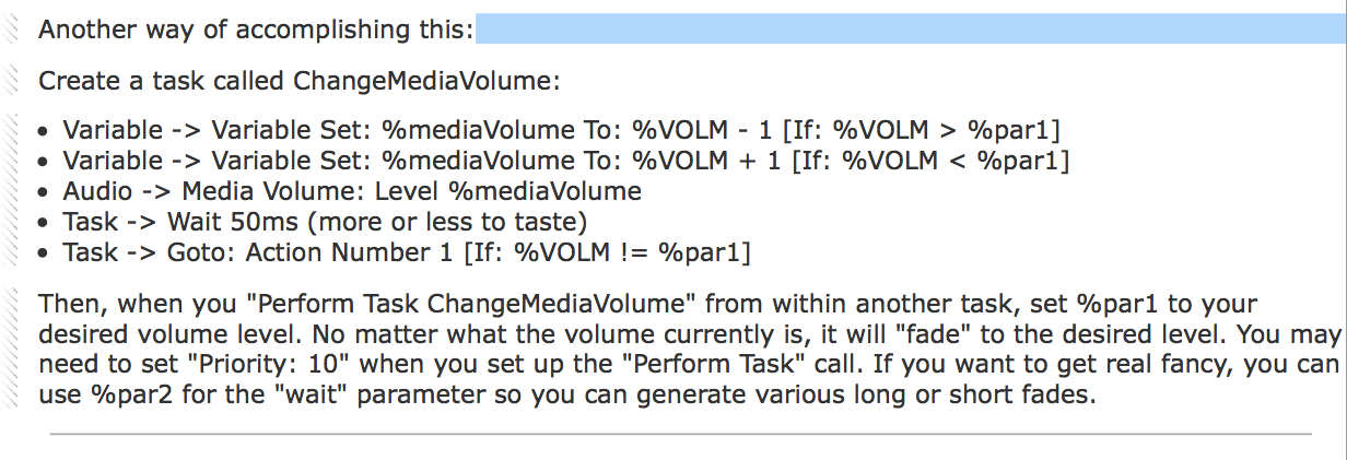

I attached the screenshot of the step through i followed. I don't necessarily need to follow this method. It's just the best i could find, however it only accomplishes half the task.
