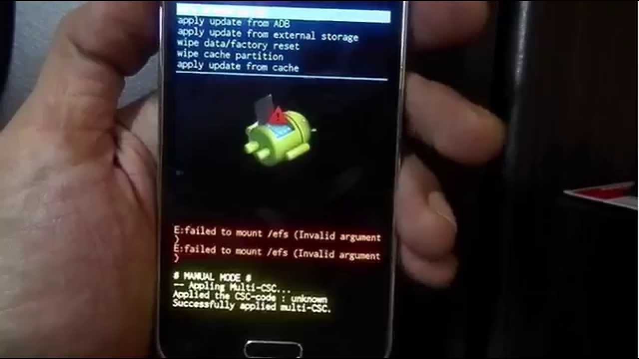

Eventually the phone started but got something similar to this screen (google images).

That screen appears to be what is commonly called "recovery" mode.
In that mode, as you can see, you have the option to factory reset which, even though it did not take long, did exactly that.
If you turned in your old device to a reputable place, I wouldn't worry about it, but let me ask, did you get the same errors when you reset? (the errors on the image and in your thread title)

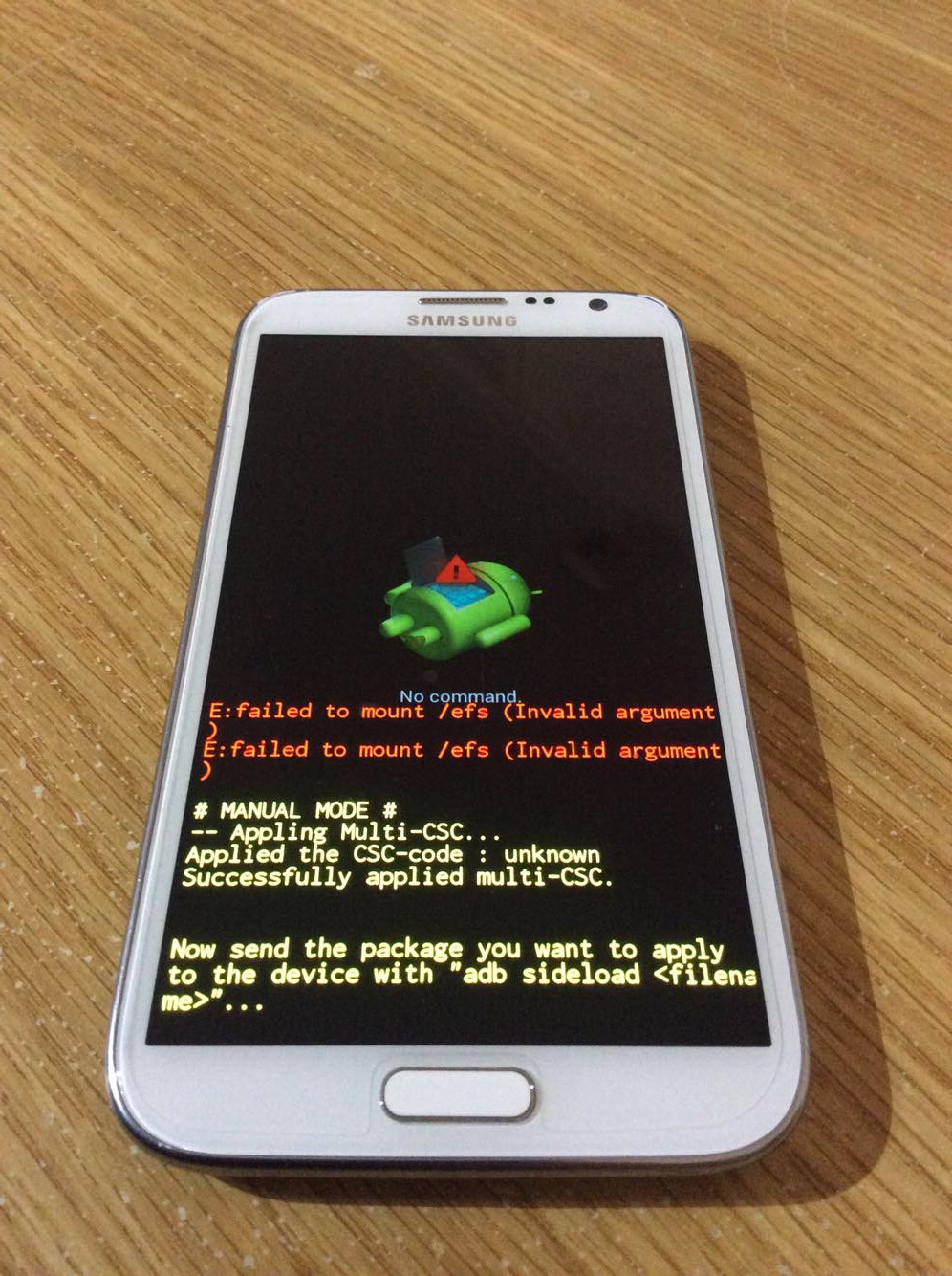

Thank you all for your answers. Yes place I used was reputable but they outsource to third party for someone to do that job. Oh well phone is gone anyway. I would only worry about all my important accounts linked specifically banking and such. Also all my photos. I found a picture I took earlier of my phone to show a friend.
