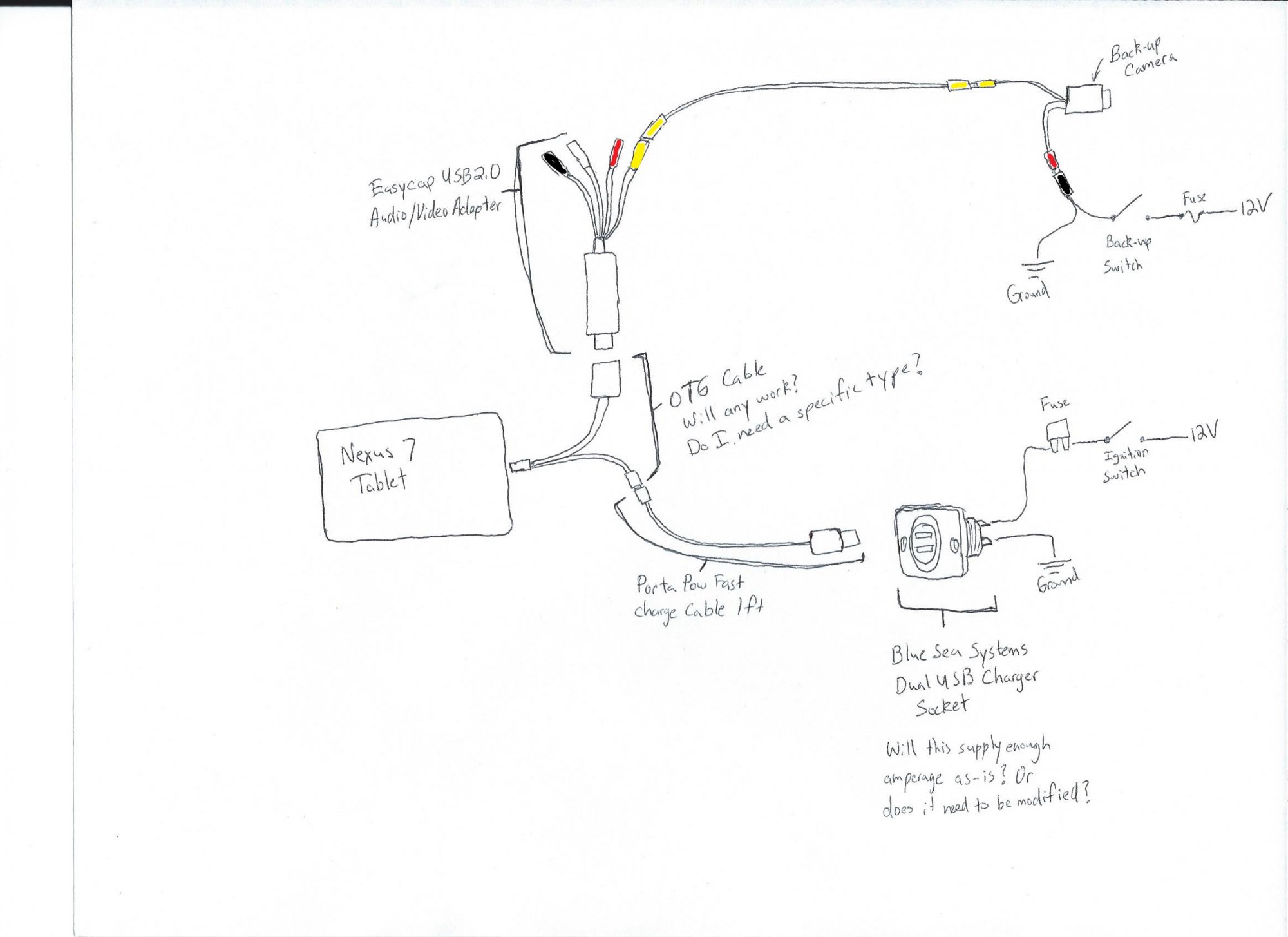

For the hardware, I uploaded a file to show my current plan of attack. Scan0025.jpg
My current questions are:
1.Will the USB port give the tablet enough power to keep it going with full brightness, Bluetooth, GPS & Torque App all running at once? I noticed on the reviews of the USB charger (http://www.amazon.com/gp/product/B0082CXEI8/ref=oh_aui_detailpage_o01_s00?ie=UTF8&psc=1) that it may need to be modified to get more charging capacity out of it. It appears that the tablet wants to see a certain level of power for it to trigger the Tasker state, and ofcourse I want it to be able to keep up with the usage of the tablet.
2. I read that a good USB cable will help for optimizing the charging rate, so I threw in the PortaPow USB cable. Since I am also planning on using an OTG cable, I hope that the OTG cable will not bottleneck the power supply to the tablet.
3. Connecting the backup camera to the tablet. I found a youtube video (
) which shows a backup camera connected to a tablet with what appears to be an EasyCap USB audio/video adapter. I am not sure if this is the right thing that I need or not to do the job? I bought this: http://www.amazon.com/gp/product/B0019SSSMY/ref=oh_aui_detailpage_o00_s00?ie=UTF8&psc=1
4. By sending power to the camera when the car is put in reverse, and a video signal sent to the tablet, I am hoping that will generate some signal that can be used to open an app to show the video. Am I on the right track here?

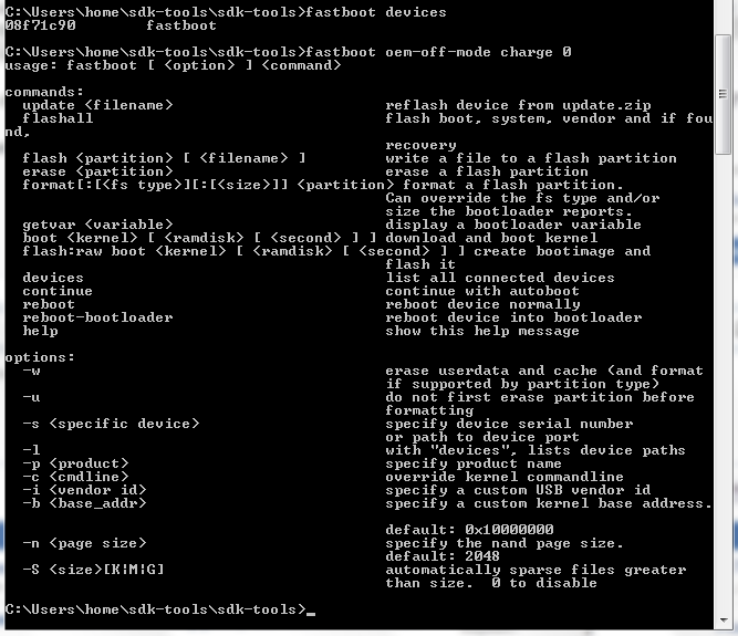

So how do you go about enabling this "power up when plugged in" is this a tasker setting?
Remember when you were rooting and had to type out "fastboot oem unlock"? It's just like that, just a slightly different magical incantation verbiage.
So basically, reboot the tablet to the bootloader, connect it to your computer, run fastboot devices from your mini-SDK tools directory to make sure it's connected correctly, and then execute fastboot oem-off-mode charge 0.
You can then unplug the tablet, power it off, and when you plug it back in it SHOULD boot up. *fingers crossed*
I'm about to have to call it a night though, so good luck - I'll find out how it went in the morning. :D
hmm, doesnt seem to be working. I am now showing the device is connected in the command prompt as you can see in the screenshot. I am in bootloader mode and I typed your command and the long script appears in the command prompt as you can see. I unplug, then power off and then plug the usb back in and the battery logo appears for a second, but tablet does not turn on.
is it "...charge o" (as in the letter "O") or is that the number zero? I tried both and I get the same result.
Sorry, I was recalling the command incorrectly. :(
I just tried it on my 2013 N7, though, and got it working:
fastboot oem off-mode-charge 0
(I had the right words, just wrong hyphenation. Computers are apparently picky about that sort of thing.)
Using the right commands should work - sorry about that! :D
That works! Thanks!

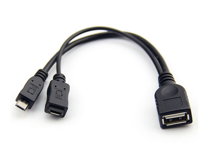

Today I received all the hardware in my diagram in the original post. Backup Camera, EasyCap adapter, OTG cable, etc. Seems that I am not getting any video signal to the tablet. I did some research and apparently there are various types of EasyCap connectors. After looking at mine, it is actually named "EasierCap", what the heck! Doesn't match the images in the Amazon product page, turns out there are sub-prime units floating around. I saw on another forum that the "correct" EasyCAP adapter has to have a STK1160 chip. I am going to try ordering another from a different supplier, fingers crossed. I didn't see any alternatives to this product, at least that people are using for this application.
The OTG cable has a poor physical connection to the tablet, it easily falls out. Dang...need to find a new one of those. Anyone have advice for a good supply? I didn't think it would be that hard to get quality hardware.
Anyway, I have a specific tasker question. As you saw in my video earler, the show-scene image would take up the entire screen, like I wanted. I know originally it took me some time to get it that way. I for some reason cannot get it to show up like that anymore....what am I doing wrong? I am using the same image (same size).
I also noticed that the OTB cable does not charge the device. Is that because it is not the correct cable, or does something with my software need to be changed to allow charging? Sorry, not a tasker question.

What sort of cable do you have? Is it a straight or a Y-cable with a separate power input?
Edit: Again, no personal experience here, but it sounds like you might need a custom kernel to enable the tablet to charge while OTG'ing: http://mehrvarz.github.io/usb-host-mode-power-management-nexus7/ That may be a good question to throw up back in the N7 2013 All-Things-Root subforum to see if anyone does have some practical experience to share . :)
I attached a reference pic of the OTG cable, not my exact one. Thy one I have just doesn't clip into the tablet well enough. You have to apply pressure on it for it to connect, no good.
I made some progress on the backup camera. From the play store, I installed an app called EasyCap Viewer. I had to change some of the settings in the app, but now I am getting video on the tablet from the backup cam and the app opens/closes automatically when the power to the camera is toggled (just like my schematic shows in the original post). I attached a picture of the test setup. Turns out the "knockoff" EasierCap actually does work after-all.
Yes your are right I did come to that same conclusion...need a custom kernel. I have emailed that guy "Timur" to see if I can get my hands on it. Sounds like that is exactly what I need.
