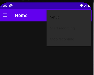

In light mode I have no problems because everything is correct but in dark mode without making any changes the text remains dark. Is it an Android bug? I have tried various methods but my problem is that I have to disable some menu options and then I lose the color in disabled mode, it always seems enabled. Is it just my problem? In this way the text is illegible I use this theme: Theme.MaterialComponents.DayNight.DarkActionBar

I tried on multiple devices and on multiple Android versions, the result does not change. This is the code for my theme.

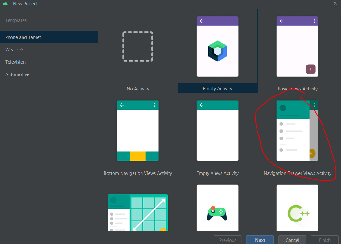

I also tried changing from Theme.MaterialComponents.DayNight.DarkActionBar to Theme.Material3.DayNight but nothing changed. I noticed that the problem is present from the start of the new project if I do it with the Navigation Drawer View. With the others there are no problems.
