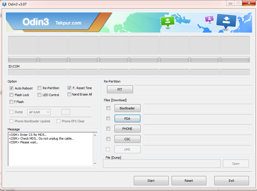

Ok i need help i was installing g apps after i got a os cynogen mod and it was working i didnt have google apps so i flashed it but it was a image file and now it wont start up i tried re flashing twrp recovery but odin wont check the md5
oml
Odin is hanging Up on Checking MD5 and not giving you a Start Button?
Try loading the TWRP tar in the PDA slot before you connect the phone to PC.
