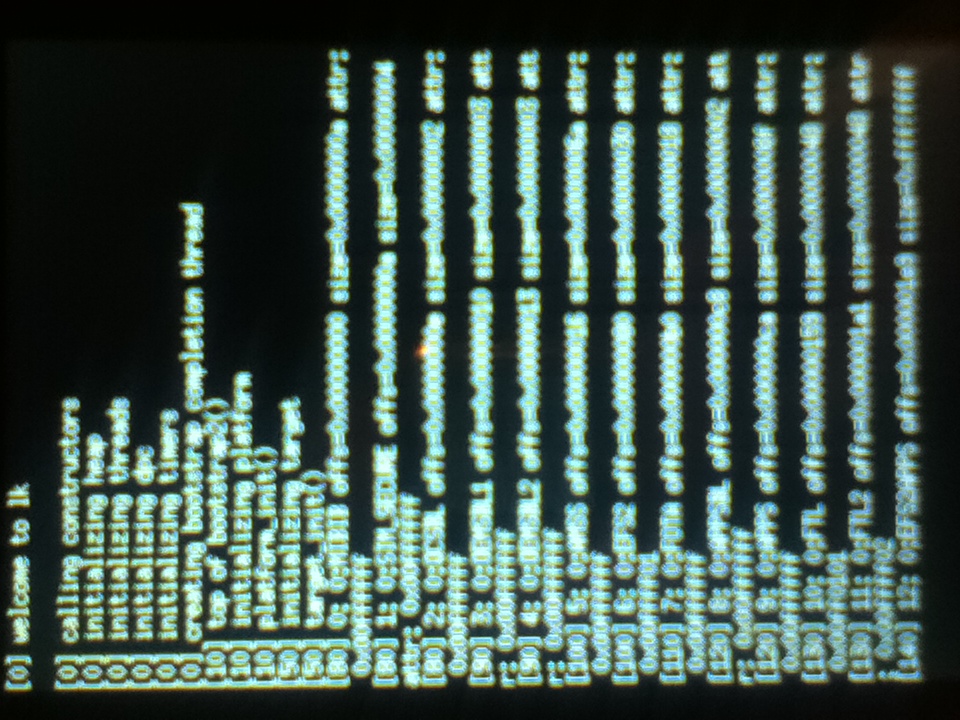

I Have Tried Everything With This Phone But It Wont Work I Cant Flash It Because It Doesnt Load Into Recovery Mode, Only Some Terminal That I Cant Edit Just Go Down With The Volume Down Button Nothing Else. Its Just Stuck At The Boot Logo Sometimes, And Im Just Stuck In Fastboot Mode :/ Please I Really Need Help This Is Urgent Heres an image of what it boots 2

Lmao Ive Tried That Dozens Of Times I Think My Only Hope Is Like idk i think i just need like a boot img or a update zip , which im trying to do at the moment , because this only lets me go onto the flashboot
