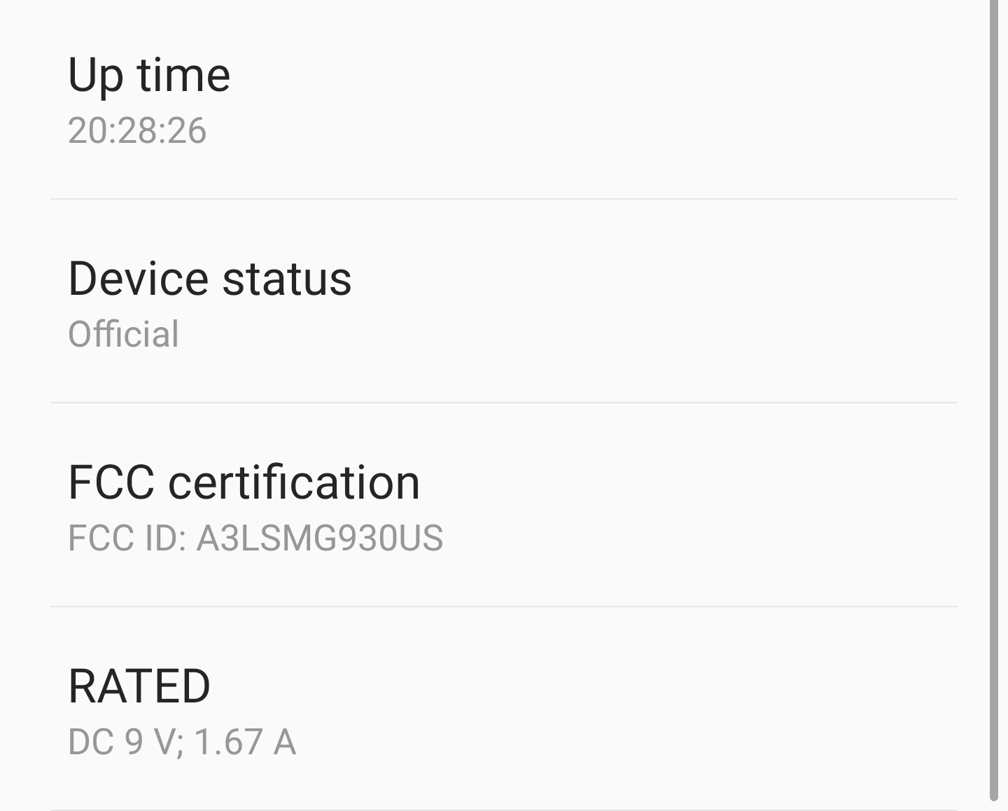

Hi hope your doing well..i came accross this and i wanted to help you get troubleshooting to see if device has been rooted
Step 1: On Samsung devices there is a status that samsung implements to dwtect if root was implemented evwn when unrooted to do this go to "Settings>About Phone>Status" and scroll down to the oprion that says "Device Status" if it says "OFFICIAL" then the phone was not tampered with in any form of way, but if it says "CUSTOM" this means the device has been altered in some form or fashion and will not recieve any system updates
Step 2: you can ensure if you have root as well by downloading this app for samsung devices this can also tell you if your device has root access https://play.google.com/store/apps/details?id=org.vndnguyen.phoneinfo
Step 3: if your phone was tampered with you can reflash the firmware back to stock using odin and i can asist you in that if you like
P.S to ever want to enable developer options samsung never has this enabled by default go to "Settings>About Phone>Build number" and tap it 5 times, if it does show as shown it in a tab named "Software Information"

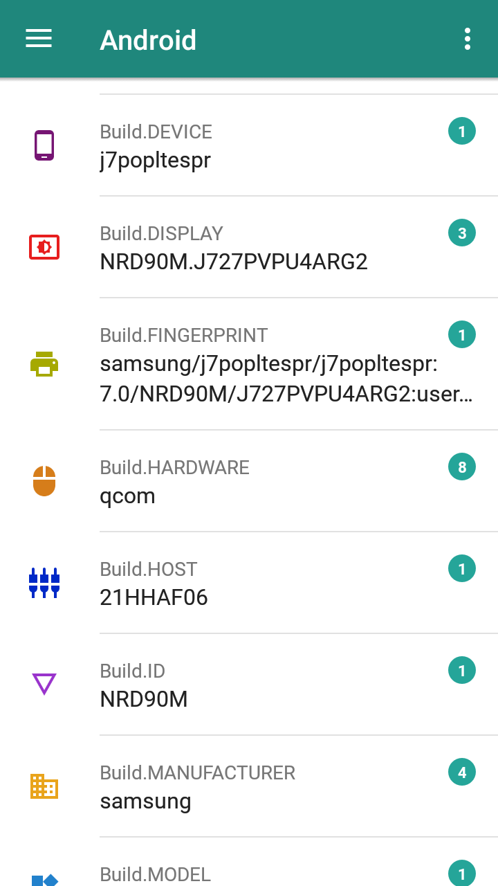

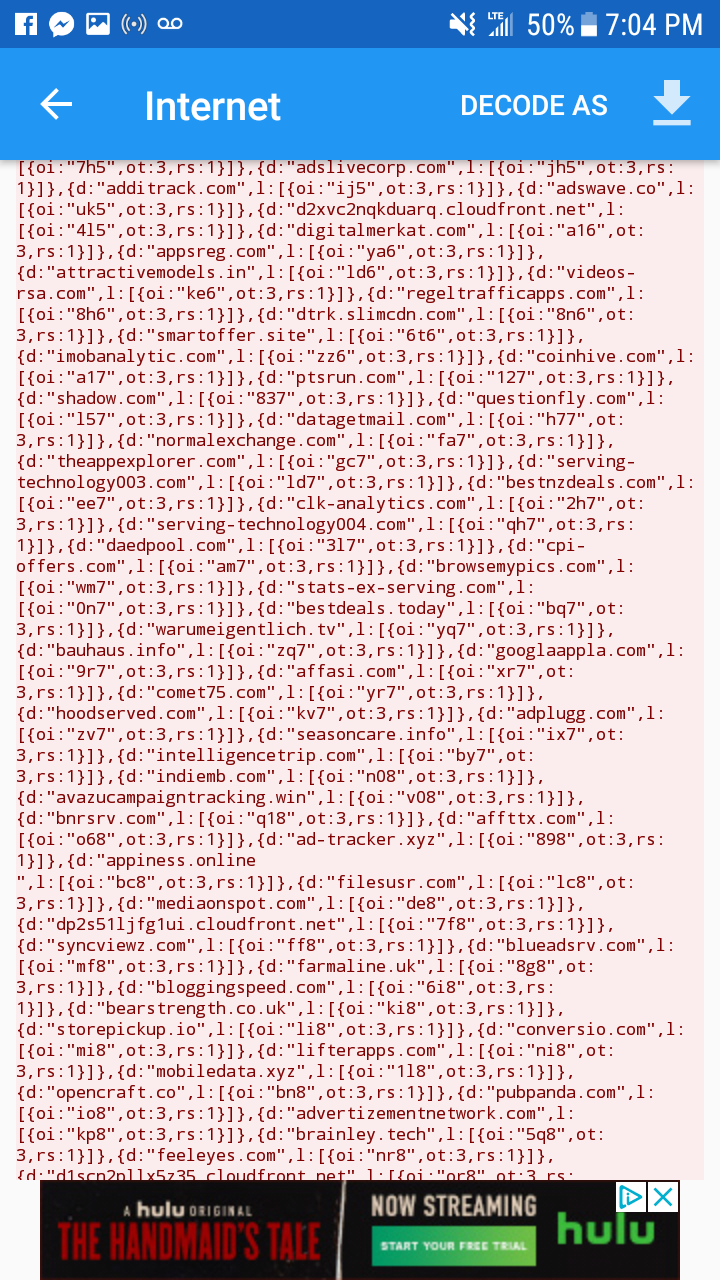

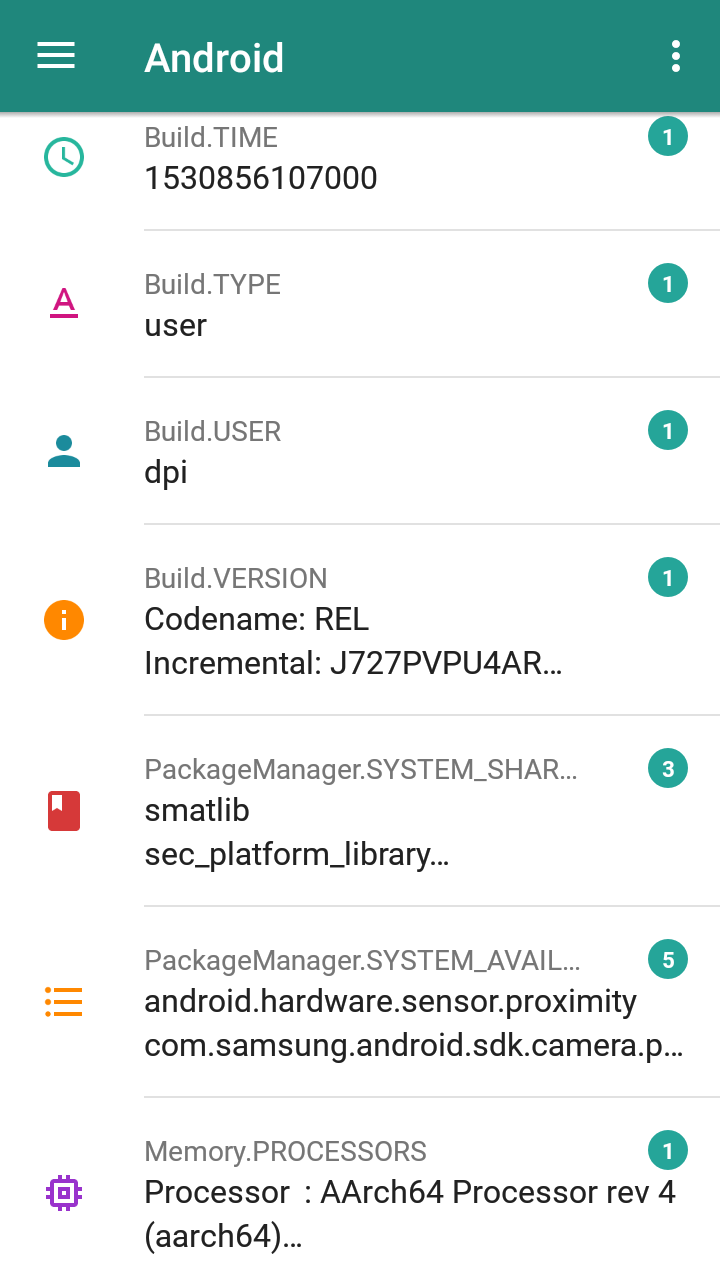

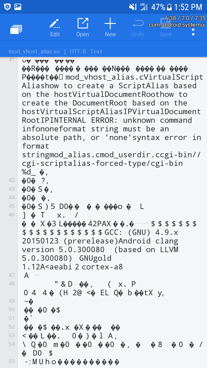

I'll check it right now.. I've also noticed it in roaming or Bluetooth on.. and I did not do it. I have developer options up that's how I found out for sure someone is in my phone.. just some screen shots from my going through crap and I'll check on the status now and let ya know what it says..

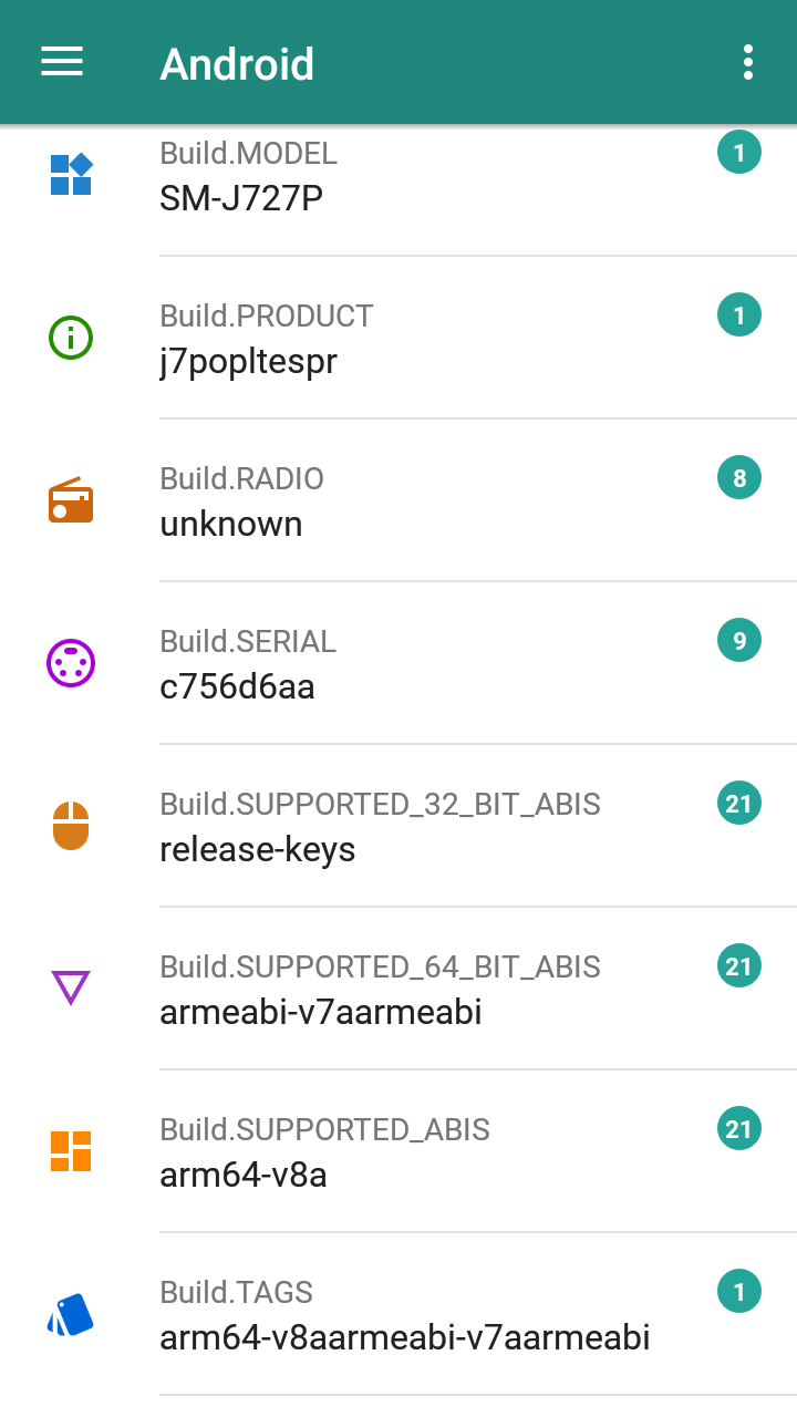

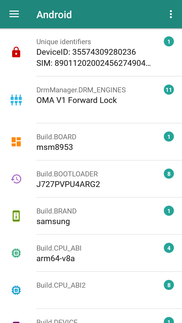

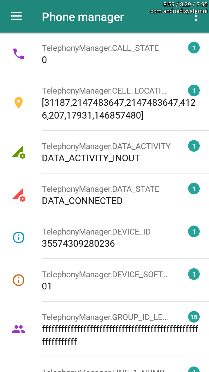

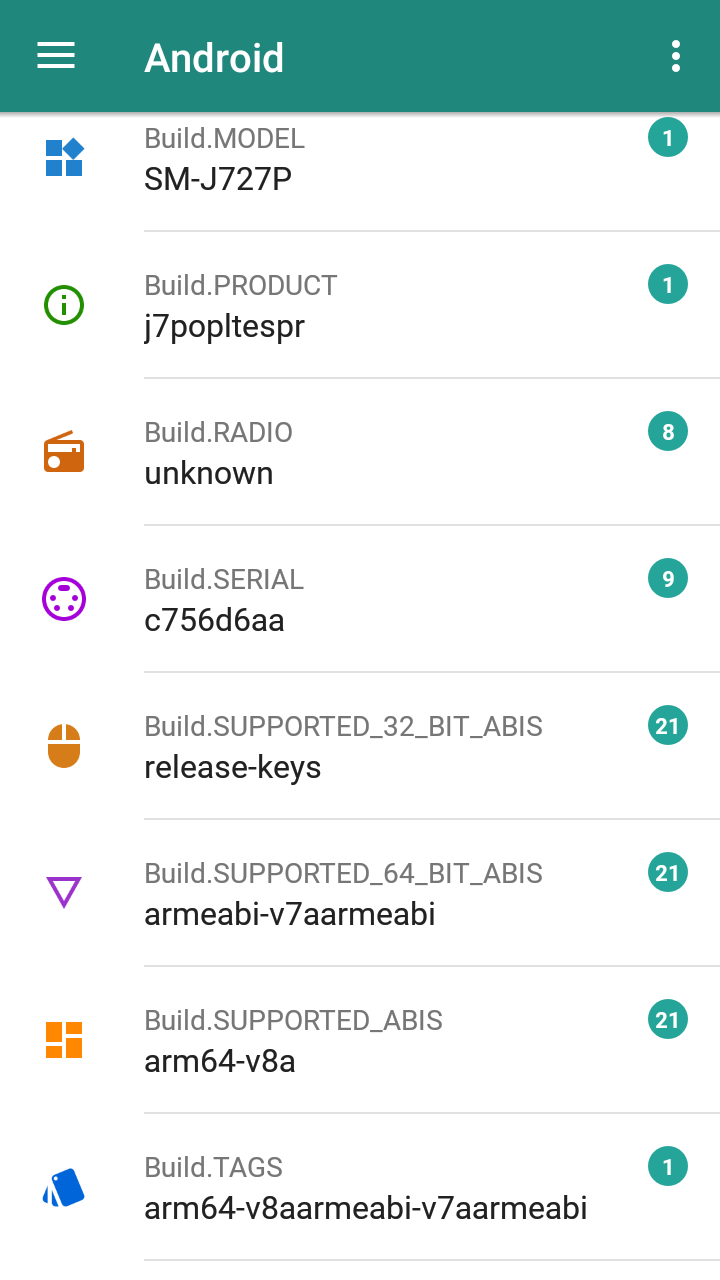

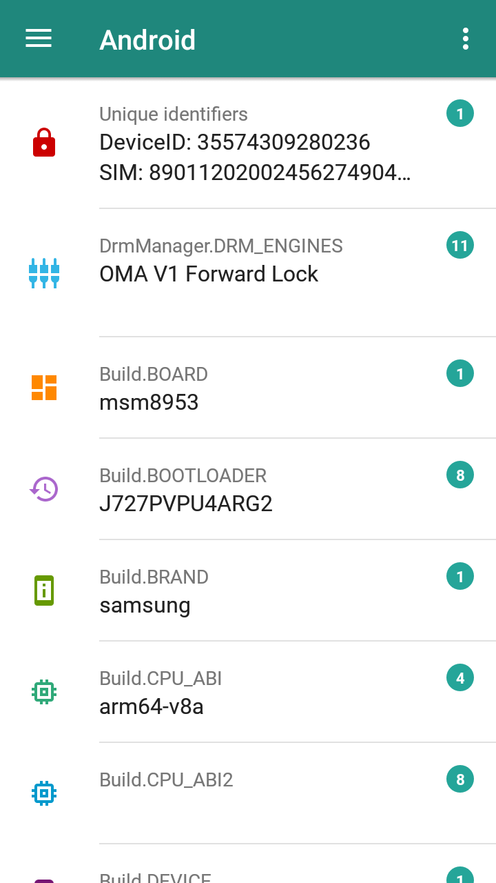

It says the right one but it also says right now I'm not on mobile data when I am.. and here is my info it says about everything basically.. look normal?

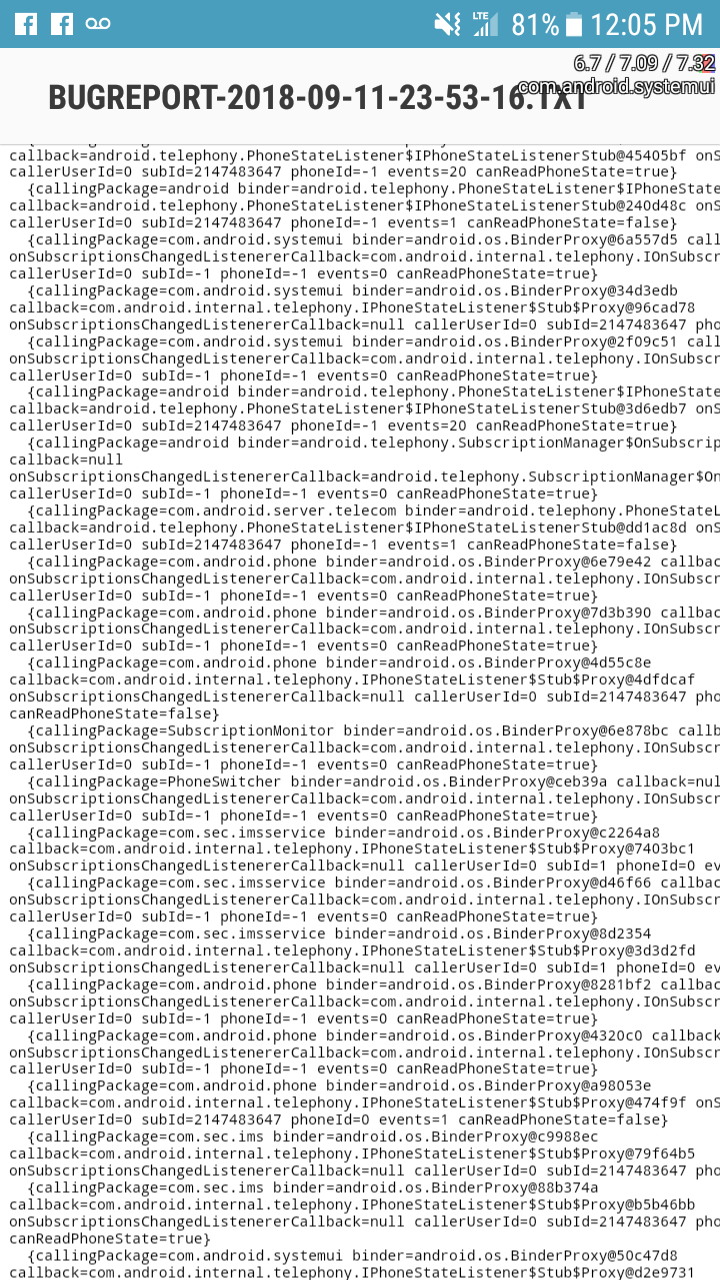

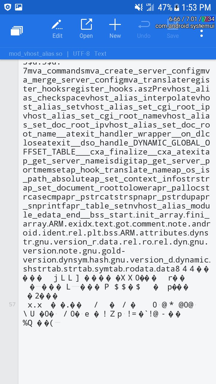

Sounds like a 'ghost app' can't find them easily after installation.. Look in Settings-Apps for something like ' data.apk', 'backupdata.apk', 'emergencybackup.apk'.. And uninstall it.. But really, @Hadron 's advice, use the nuclear option and flash the stock Factory FirmWare as it'll wipe any Rooting or Root attempt done to it.. Then put a tough screenlock on it

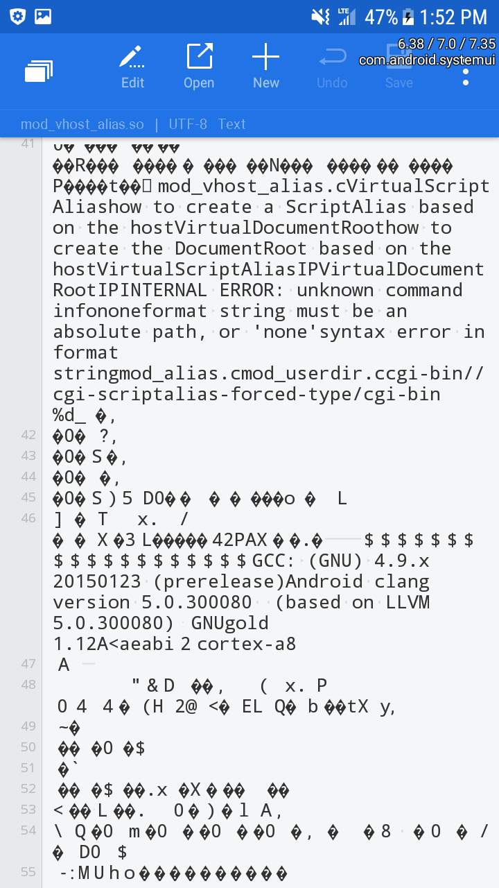

Also has a ghost Admin... I'll install an app then I installed an app to let me know when files, apps, anything was deleted or moved and apps would be moved to inactive, icon deleted, yet the app is still on my screen and usable. Permissions completely changed. It'll kick up half if not more of my system settings as fake apps.. I found Changelog in my phone but no permission to access it. Android developer.. same.. damn why cant he just go through my phone like normal insecure bfs!!!

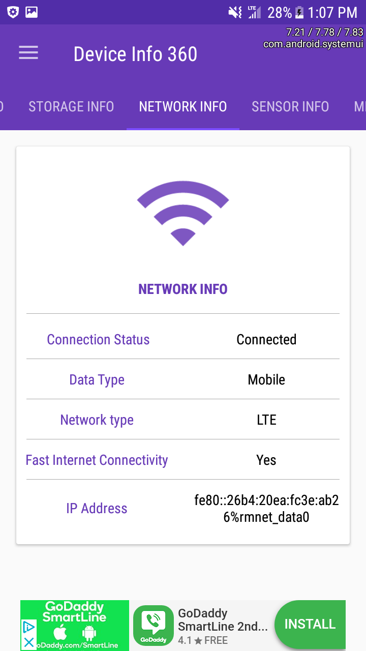

This is what I get when I try to root....
