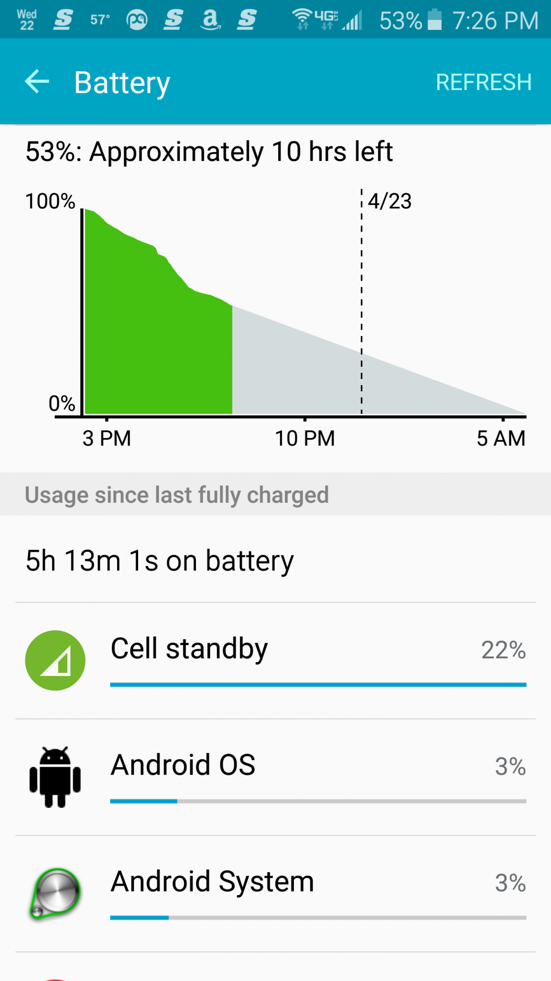

Ugh, this battery drain is killing me. Been home all day on Wi-Fi with full 4g bars. Anyone finding this usage abnormal?

I can see 29% of usage accounted for there, 23% from cell standby. So what's used the other 71%? That seems a more important question to me.
I know what you mean and get what you're driving at, but the rest of the 71% are apps that I'd like to be running and taking up that %. I've only been on Android since the Motorola RAZR M (so not that long), but I've never seen a correctly running app take as much percentage as Cell Standby, other than the screen. Just trying to see if there's an issue on my phone that I can target.

Unfortunately not all software calculates power usage in the same way. For example, if I look at my system power menu it will tell me that cell standby was 90% of my power usage today, and a browser and a couple of news apps the rest. This is in fact nonsense - I've used 40% of the battery, and in the time the phone has been on battery I know that if I'd just left it sitting untouched with the screen off it would have used just a few percent. GSam Battery Monitor tells me that my screen has used 39%, apps 48% and the phone radio 8% - that sounds much more accurate, because 8% of 40% is 3% of the total charge, which is about what I'd expect if I left it sitting untouched for 8 hours with data connections off (e.g. overnight).
In fact I can see what my phone's power menu is doing wrong: it tells me that what it calls "cell standby" is using 59% of the power in the 1.5 hours the screen was on, and 99% of the power in the 6.5 hours the screen was off, and averaging these two numbers to give 90% overall (because (99*6.5 +59*1.5)/8 = 0.9). That is however stupid, because almost all of the power drain occurred when the screen was on, which that calculation, just weighting by time, ignores (plus I don't believe that it actually used 59% of the power when the screen was on either). What that tells me is that whoever wrote that bit of the system software is an idiot! ;) Now whether your phone has the same problem depends on whether the idiot in question worked for HTC or Google, and if they did work for Google whether someone in Samsung spotted this and fixed it in your phone.
I suspect your display might not have this problem, because if I look at your numbers the phone used 47% of the battery in 5 hours, of which cell standby used 22%. So 0.22*47/5 = 2% per hour from cell standby, which is a little high, but perfectly possible if you are moving around (so switching cells) or spending time in places with a weaker signal. And as you say, there is the question of what they are lumping together under that heading of "cell standby".
But I would suggest using GSam to get a better idea of what is really using the power, and working from there.

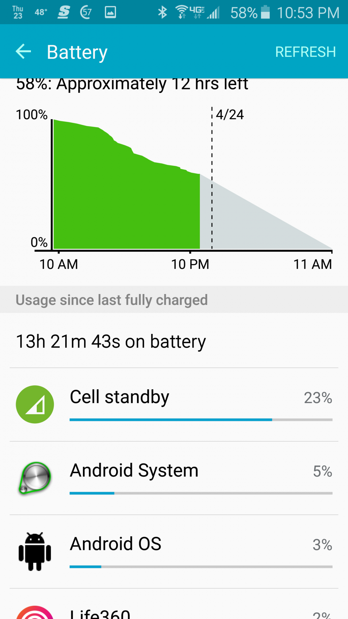

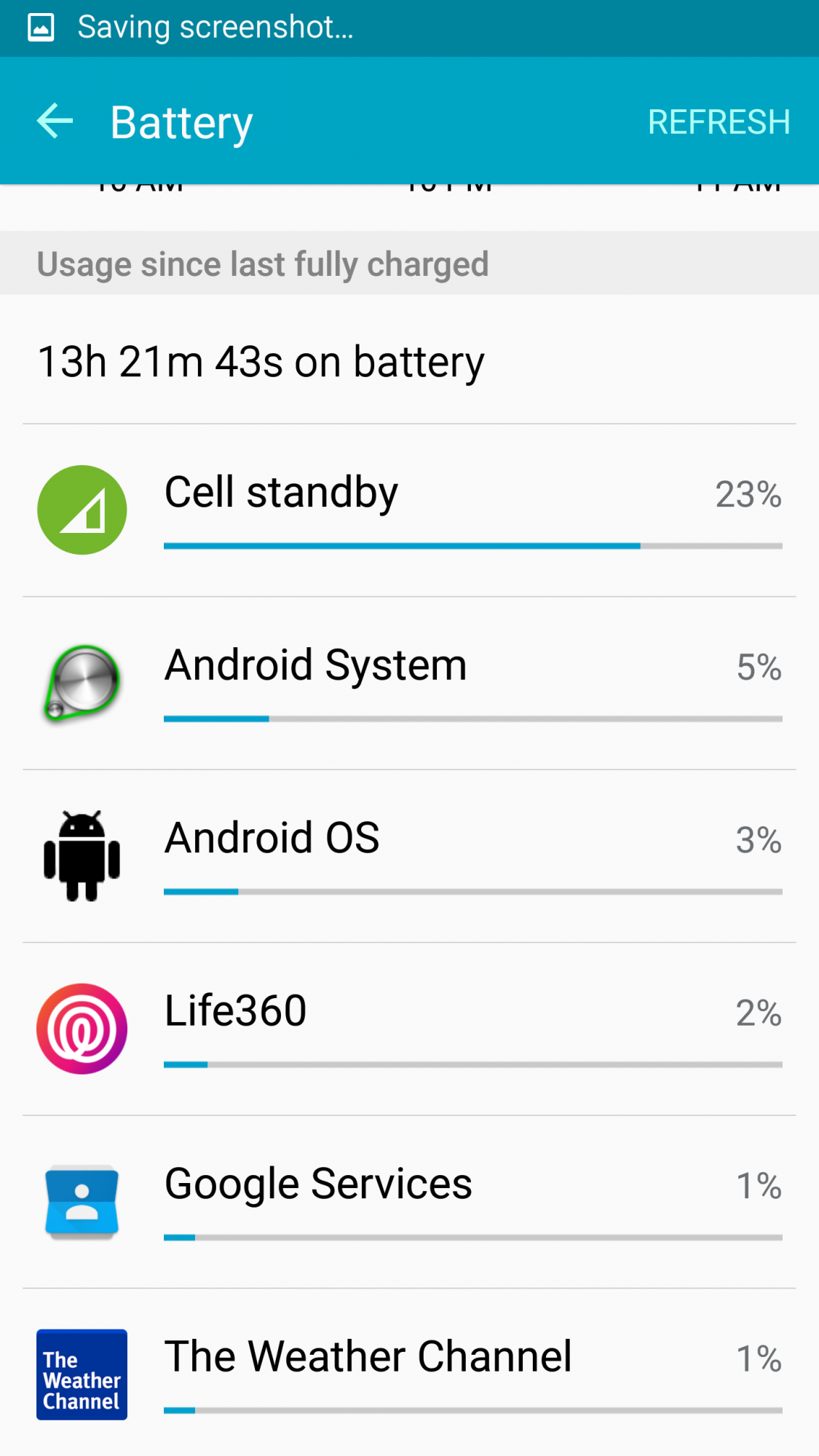

My Cell Standby is ALWAYS high and always at the top of the list unless I used a particular app or lots of screen time that day, which is rare. Yesterday was the highest I think I've seen it. And I used the radio.com and Amazon music app for a large portion of the day which I don't normally do, so I'm wondering if it is somehow related.

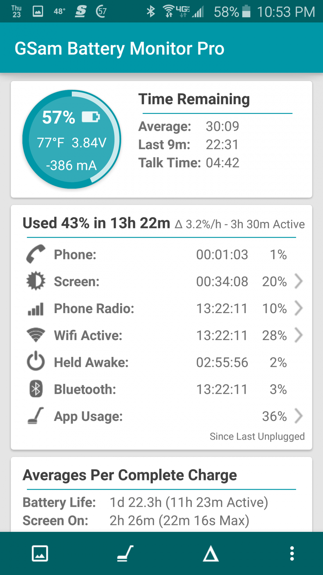

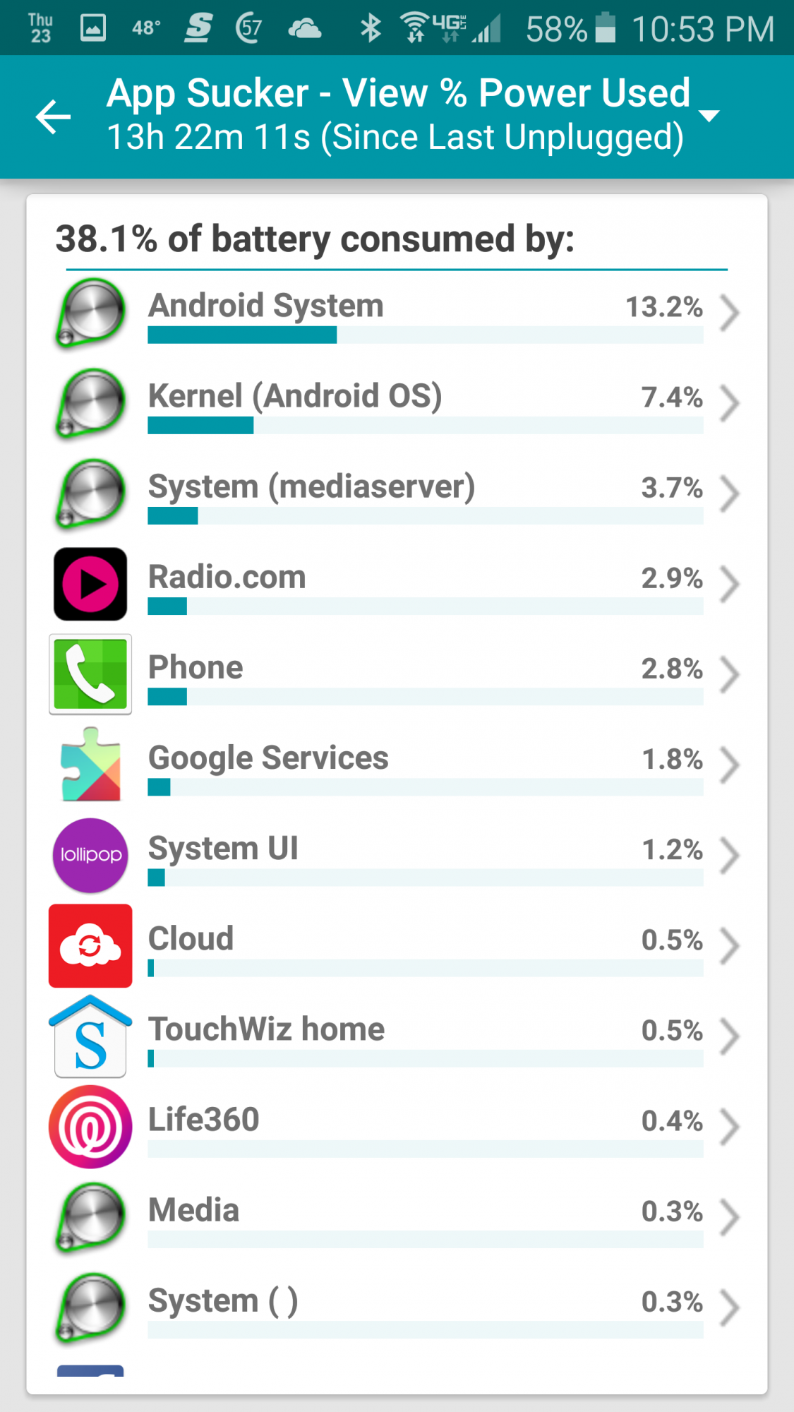

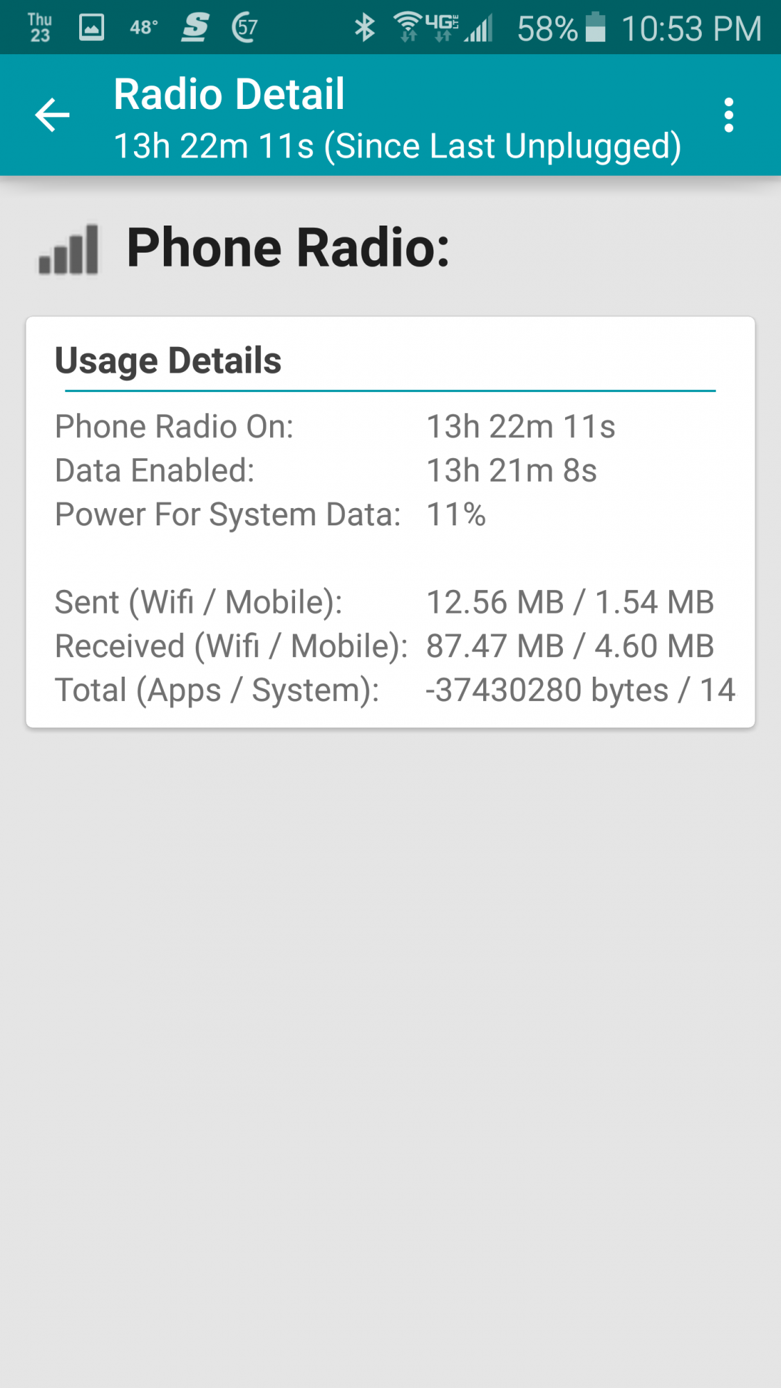

So here are my latest screenshots. I checked it a few hours in and Cell Standby was at the top of the list, but was a pretty low percentage. I started using the radio.com app and it seems to have grown larger. Odd that GSAM doesn't really show the same thing that the battery app does as far as 24% cell standby
