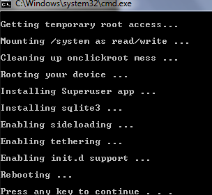

I just tried rooting with Aroot. Ran the .exe file
It ran and restarted my phone. (attached screen shot of what it said).
I didnt see any SU icon after reboot. I tried running barnacle and it said i need "SU access". So i guess its not working for me either.
