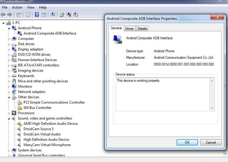

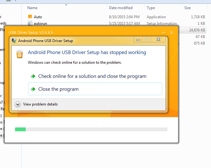

I installed the usb driver from my phone but I get an error yet still says the driver is working properly but still can't find my device in cmd with adb devices... and when I launch droid cam, it uses the adb from droid cam and still can't find my device..

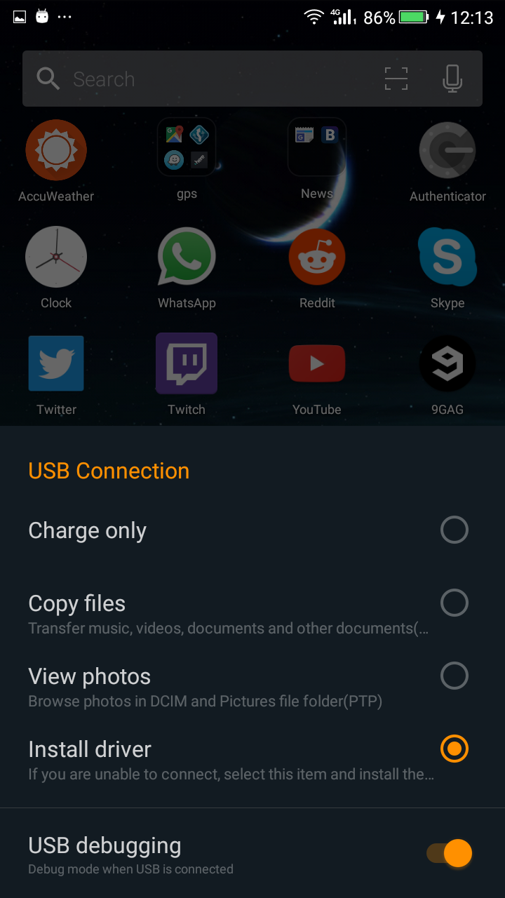

Hi, i finally resolved my issue with droidcam not finding my device. When you connect your phone to your pc click on the USB options and select connect as "midi" that worked for me today. you're welcome

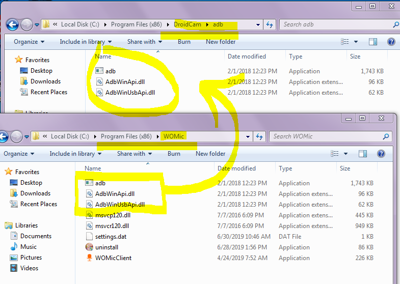

I had wo mic Installed I found 3 files similar which were in droid cams adb folder ,
I copied those 3 files from wo mic and replaced them with droid cams adb folders 3 files .
I have attached screen shot please have look and use droidcams updated drivers .
Please uninstall mobiles drivers and reinstall it .
and enter 0.0.0.0 in wifi first then move to usb as in my mobiles client it was 0.0.0.0 I entered it in desktops clients folder
for using wo mics folder the signature update of windows 7 64 bit update of this link is required -Windows6.1-KB3033929-x64
https://download.microsoft.com/down...F02-B2A9A1238099/Windows6.1-KB3033929-x64.msu
in any problem you may revert me back thank you and enjoy
