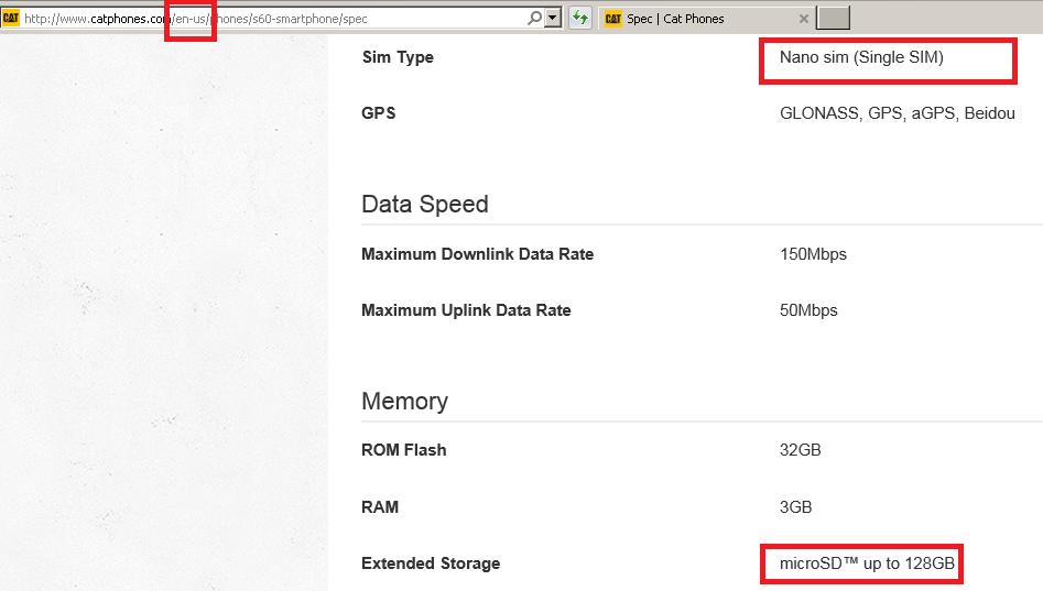

Are you guys that have these so in America getting the dual sim or a single sim version?
The specs on the phone I ordered were dual sim, but that seems to be the only spec different on the canadian version. So I assume it should still work with AT&T. Anyone have one they can check?

This is the first I've heard of the single sim option. I have the US version, and it has two sim slots. I've been using it on AT&T for a month now with no issues. I get 26Mbps download, 6Mbps upload. I'm in SE Virginia, so ymmv depending on your location.

Hopefully this is just an error on the US site. I have seen some specs show its good for up to 200GB as well.

The US version "has" 2 sim slots but slot 2 is in-operable, at least on mine and it also uses different bands than than the dual sim version. To my knowledge slot 2 is software disables due to the bands used.
It is single sim, for the Micro SD it is common to list 128 but any correctly formatted microSD high capacity should work. I only have a 64gb at this moment to test with as I sold my 200, or was it 256? I don't remember right now.

Update: The Canadian version I received does not work with the 2 sim cards at the same time. I had to remove my Canadian sim to put the AT&T sim in slot 1 to get it to work on AT&T. Then my Canadian carrier no longer worked with this sim in slot 2. This is very disappointing since dual-sim was a big part of why I bought this phone. On another note. I couldn't get reception along the Hana highway in Maui, where AT&T says the have 4g base on the coverage map. Does anyone know what bands they use there or do they just over estimate the coverage area?
I guess the big question that I have is why would the North American version have the second SIM slot disabled? I'm genuinely curious as to the reasoning behind it.
My S60 also had the 2nd sim disabled. CAT support said the phone had to be replaced to get sim 2 to work. Took it to the local agents and they did software upgrade and now it works.
