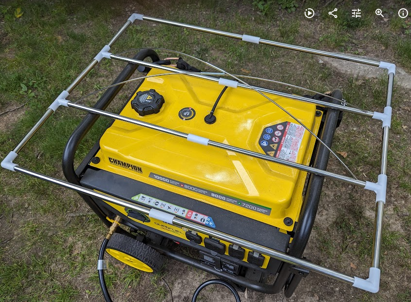

At that point, you can decide what you want to power by turning off breakers. I'm able to run my whole house on an 10000w Peak / 8000w running generator. I went with a Champion Dual Fuel as I wanted to mainly run on propane since a) I have a lot around b) it is easier to get your hands on when the lights are out and everyone is scrambling for gasoline for generators, and c) it doesn't go bad so it is easy to store. I also have the option of running gasoline in a pinch.
It runs all the essentials without a problem. I just have to avoid running the dryer and oven simultaneously. It easily handles my well pump, furnace, and water heater along with the lights and other entertainment (switching all my lights to LED over the years certainly helps with this).
All told, the generator was $1,100 and the electrical work was part of a larger remodel but I doubt it was more than another $1,000.

BTW, this is what I have for a generator.
