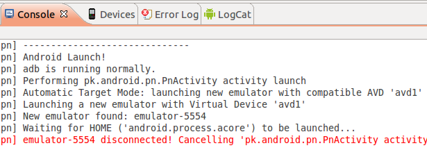

I attached picture of the Console Window.it shows events next Run
Project Name: Pn
Activity Name: Pnk.android.pn.PnActivity
AVD name:avd1

It looks like avd1 is starting, but then dying or is being closed before android fully boots.
Try going into the AVD Manager. Delete avd1. Create a new avd. Choose a target and small SD Card size, but don't change anything else. Then start the new AVD from within AVD Manager. Does Android boot?
