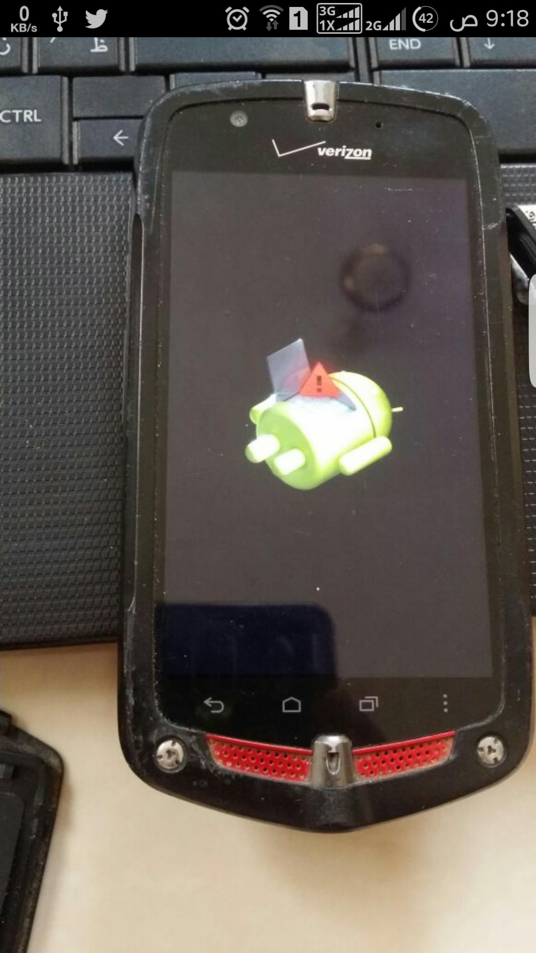

my device cant boot and recovery cant enterying any soulition to repair it
