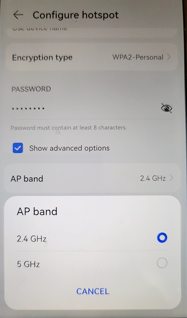

You should be able to turn off the 5GHz AP in your WiFi router's admin settings, and just have the AP as 2.4GHz only.
I can do it with my Huawei phone with Harmony OS, turn off the 5GHz AP in the hotspot options. But I'm sure most routers have similar options, to have 2.4GHz only.
Thing with 5GHz WiFi, depending on the construction of the premises, it can be rather line-of-sight. 5GHz microwaves just bounces off structures like foil lined plasterboard, and steel reinforced concrete. Even traditional brick or stone walls can be quite opaque to 5GHz.

But you should be able to disable the 5GHz on your WiFi router though, via the router's admin settings, which you should be able to do with just a phone or tablet. Usually you connect the browser to a certain IP address in the router, and that shows the admin pages and configuration. It might be something like 192.168.1.1, or 192.168.1.100, etc. depending on the particular router, like Linksys, TP-Link etc.
