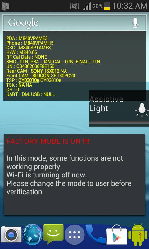

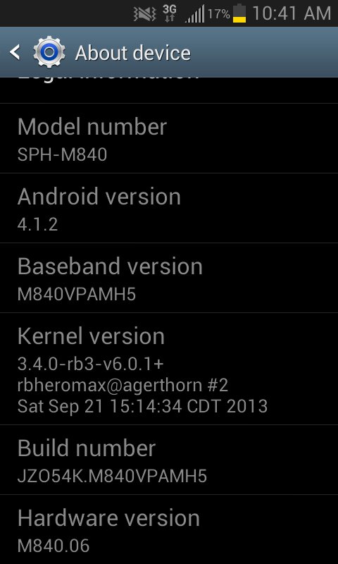

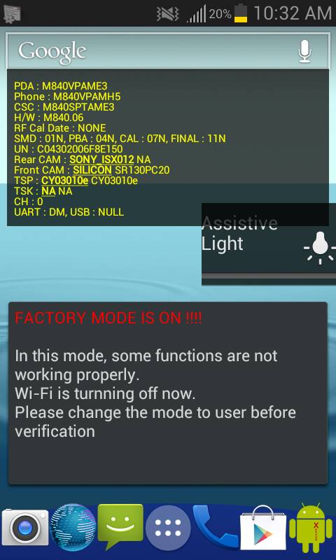

update finally got to get rid of the annoyin factory mode but the dwnfall my long press power button immediatly powers off the reboot mobile data toggle airplane nothin shows need flash efs or settings.db
I had this same issue I followed the instructions from the link above (the link for the note) and now have my lock screen and power menu back been at this since Christmas. In terminal emulator in Rom Toolbox pro I used this command
rm /efs/FactoryApp/keystr
rm /efs/FactoryApp/factorymode
echo -n ON >> /efs/FactoryApp/keystr
echo -n ON >> /efs/FactoryApp/factorymode
chown 1000.1000 /efs/FactoryApp/keystr
chown 1000.1000 /efs/FactoryApp/factorymode
chmod 0744 /efs/FactoryApp/keystr
chmod 0744 /efs/FactoryApp/factorymode
reboot
Good luck! Hope this works for you as well
