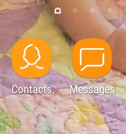

Another thought, just having looked at my phone and found those settings hidden at the very bottom of the info for a contact (didn't look for group), but did the update switch you back to the Android Contacts app (which on the Android 7 iteration looks like an orange square outline with a line drawing of a male head inside) instead of keeping you on the Google Contacts app (which looks like a blue square with a white "generic human - probably male" icon in the middle)?
If that's what happened try getting Google Contacts again from the Play Store.

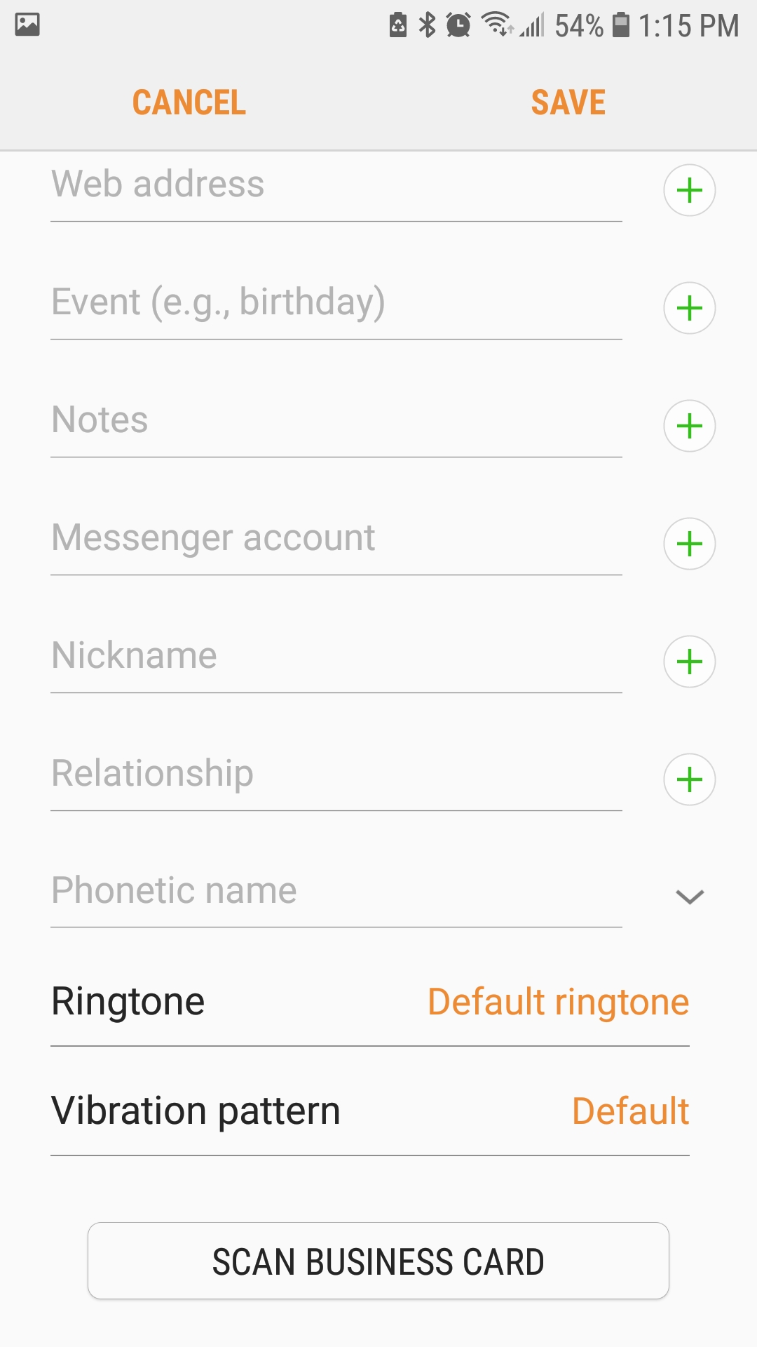

Viewing a contact, scrolling to bottom there is 'view more' - The notification setting used to be there.
(Edit - *Editing a contact* - not viewing a contact)

These settings are in My Contacts. If I update Messages or use a different messaging app, you're saying it will fix the contacts, so I can have specific message sound for, example, my daughter???

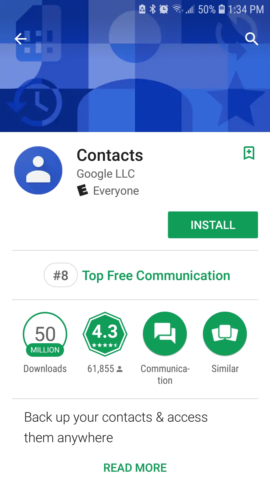

Sorry I've got so many questions here... Is this the Google contacts app u r referring to?

First, with regard to your question about Google Contacts, yes, those screenshots are for the correct app, but it does not restore the custom text message notification sound.

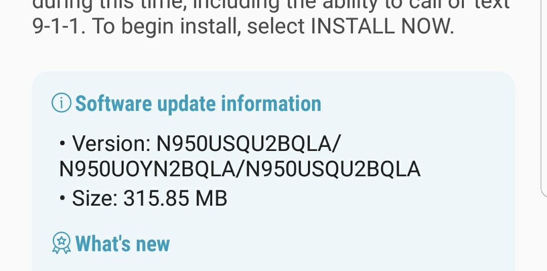

Hi folks. I got a new Note 8 & the software update from T-Mobile keeps popping up. I, now, have the ability to assign individual contacts, a specific notification sound. If I update, will it go away?
(Update info attached, I hope)
