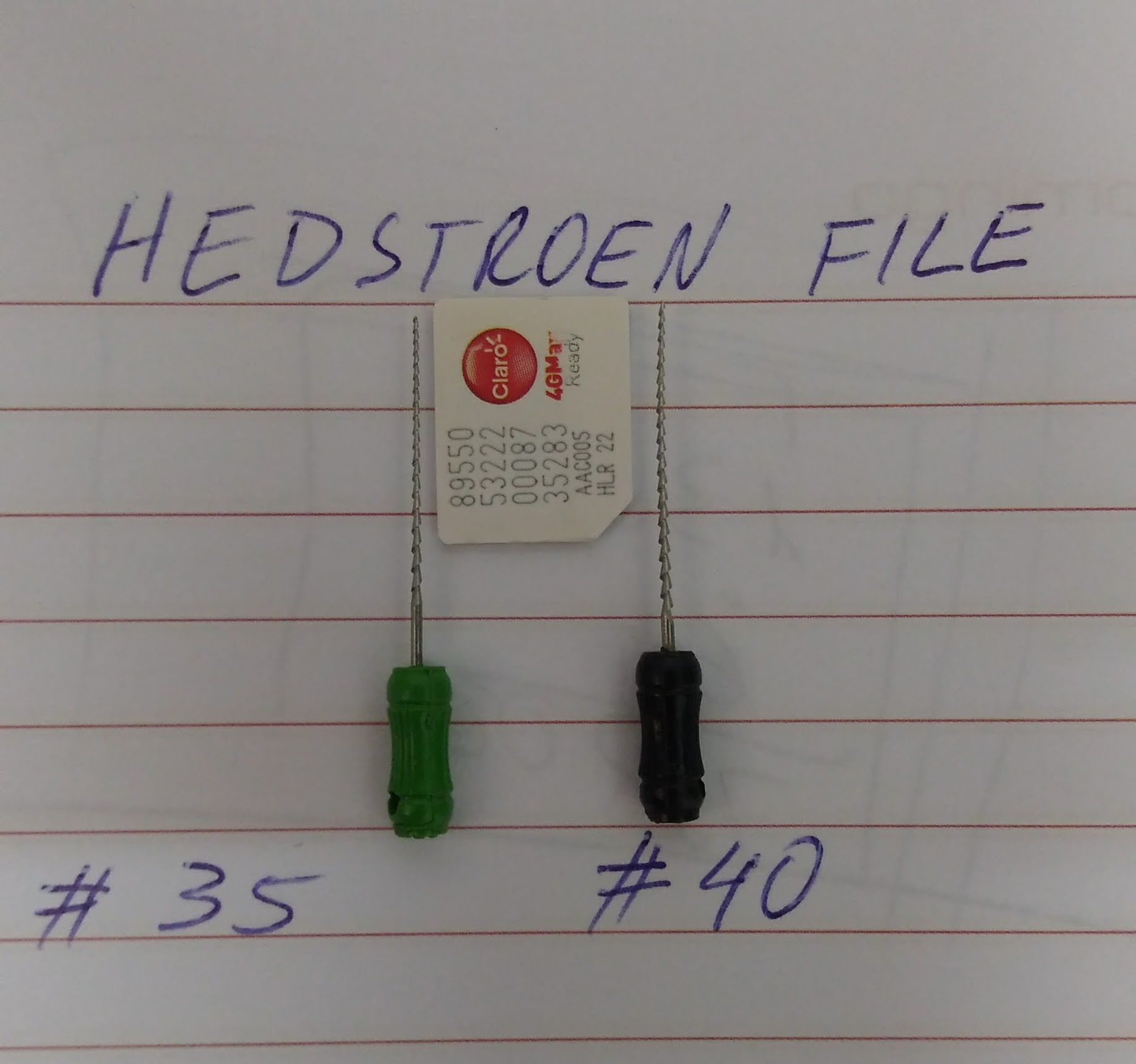

The easiest (not necessarily the cheapiest) way to remove a nano or micro SIM card from a wrong slot is using a dentistry hand tool called Hedstroen file. It's a tool for root canal and it looks like a needle with micro hooks around. Just insert one file on each side of the card and pull them parallel and gently, working as a pair of tweezers. I used a file #35 (green) and #40 (black). A set of files ( 1st serie, #15 to #40) costs no more than US$10.00.
