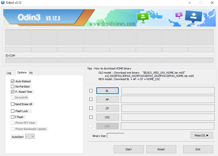

Running Odin3 (v3.12.3). I do not see an "OEM Unlock" under options in Odin (image attached). I am in USA.

Oem unlock is in developers options. Unless you previously tried rooting the device, it's probably off. If you can boot to the stock recovery after the firmware flash a factory reset should work. If not, it'll more than likely be a hardware issue.
