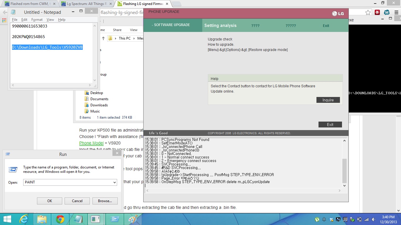

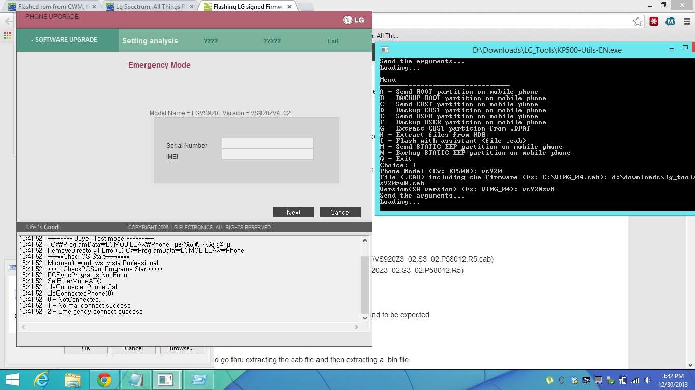

So every link I come across to the LG Update tool, links me to a LG page for the LS980, there are several links, but no downloads. This seems to be the only thing I'm missing. A proper link would be appreciated.
Edit: Trying Old Method from this link, will report back if successful
Flashing LG signed Firmware - LG Spectrum - RootzWiki
Edit2: I followed the direction almost exactly, but the LG tool isn't doing what the poster says it should be doing. I took 2 screen shots and attached them to this post. Also when I rooted it it was on zv9. I'm just not seeing any other recovery options. Thanks for continued help.
Well, you found my post, but you're not really reading it. The top has new instructions that say to skip the KP500 tool. As for your phone, it's possible that the battery is dead by this point if all you're getting is blinking lights.
I'm going to ask a silly question, but did you do anything besides flash V2.0 from that link you gave me? The info I have from you does not match the scenario I'm seeing. That ROM wipes out 4 partitions, which on our phone are TZ, SBL3, /persist, and /recovery. None of these partitions should be needed for Aboot to start up and kick over to download mode, or at the very least, you should be able to bring up the "factory reset" screen, even though you no longer have CWM on there. Any extra info you can provide, can help me trouble shoot your issue.
I'm going to ask a silly question, but did you do anything besides flash V2.0 from that link you gave me? The info I have from you does not match the scenario I'm seeing. That ROM wipes out 3 partitions, which on our phone are SBL3, /persist, and /recovery. None of these partitions should be needed for Aboot to start up and kick over to download mode, or at the very least, you should be able to bring up the "factory reset" screen, even though you no longer have CWM on there. Any extra info you can provide, can help me trouble shoot your issue.
