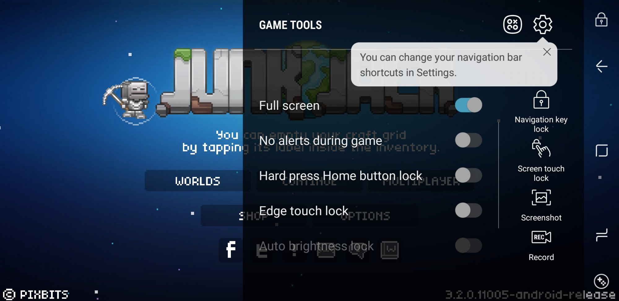

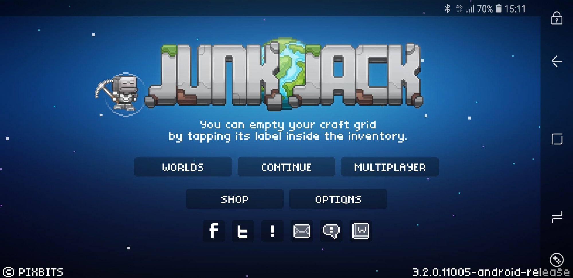

Are you using the Samsungs game tools feature? The notification I see on your image does not match what I would see when using the full screen mode.
Even if I reset the Game Tools app data back to default I do not see that notification on my S8+.

You would have to factory reset the phone to make it appear. I'm certain that this message is from android itself as a similar message appeared on my LG, which has android v7.0, the first time I launched a app that hide the nav bar. The message screen itself doesn't seem to accept any input however I can make the nav bar appear if I swipe down from the top to reveal and interact with and return to the home screen directly by pressing where the home button would be if it wasn't hidden. So when this appears I'm not locked out of the phone just the app. I would also like to note that if I run the app in split screen the message doesn't appear, which makes sense given that it isn't running in full screen.

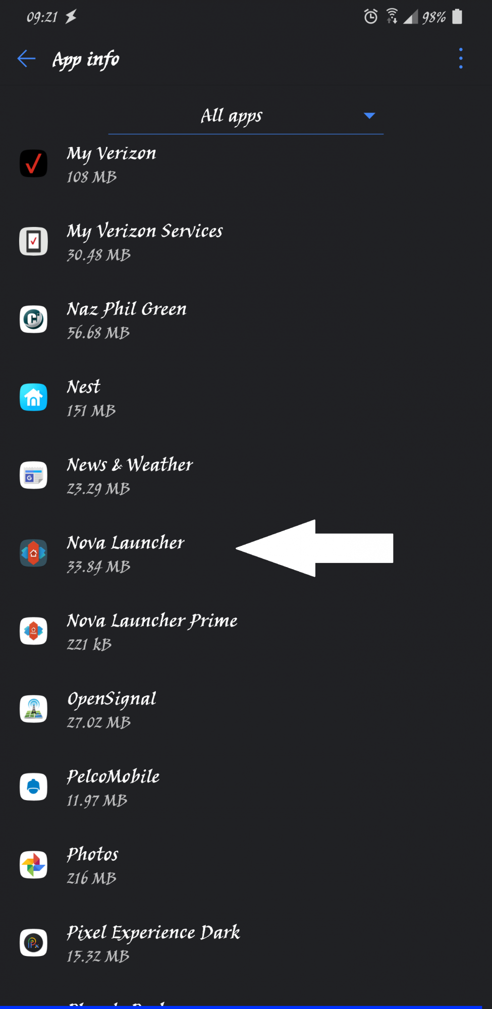

I meant your built in launcher. eg, my stock launcher is called, "Home"
vs my 3rd party launcher called, "Nova Launcher"
But if a factory reset didn't help, I'm not sure what to do. I wish I had your device to tinker with it and find the solution :(
