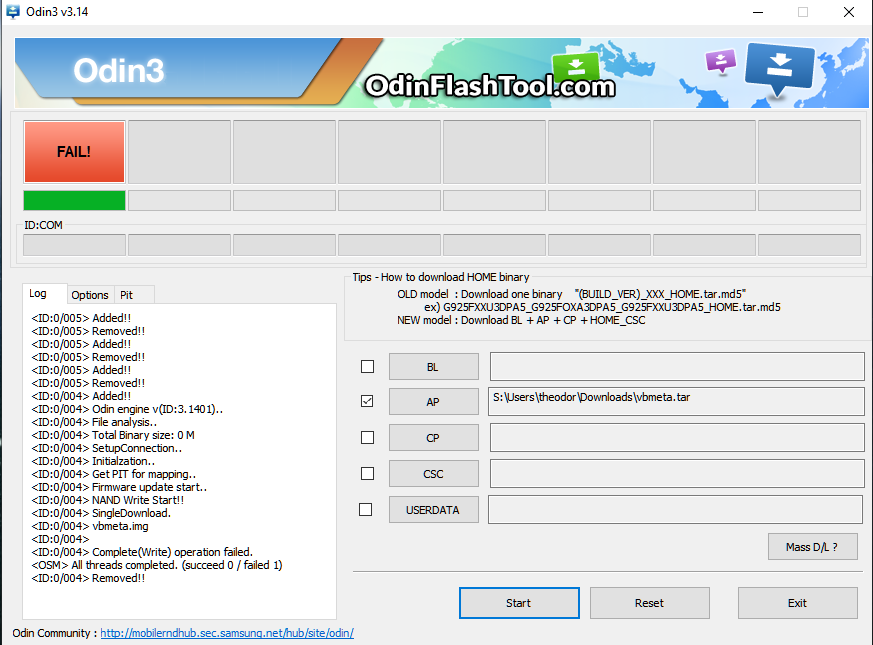

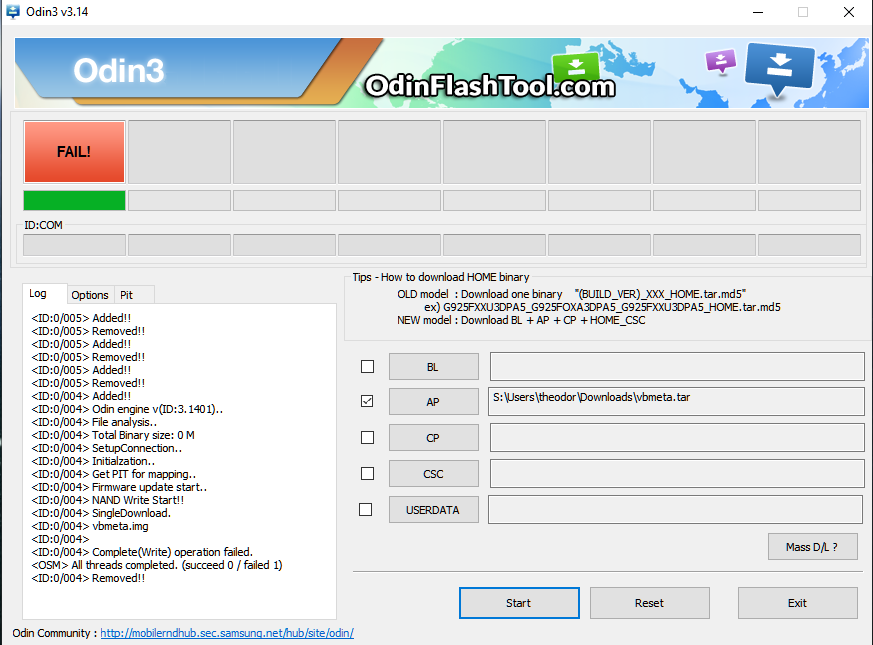

I get this when I try to flash the vbmeta from the link
My Phone tells me it got blocked by oem lock or just reboots into "stock"

from what i have heared you need to unlock the bootloader not just allow it in the dev settings?
but that would wipe my data. so i would need to back it up and then unlock it.
Backing up now with smart switch, could unlock it now
yes you are right......adb fastboot oem unlock bootloader does wipe data.....forgot about that.
