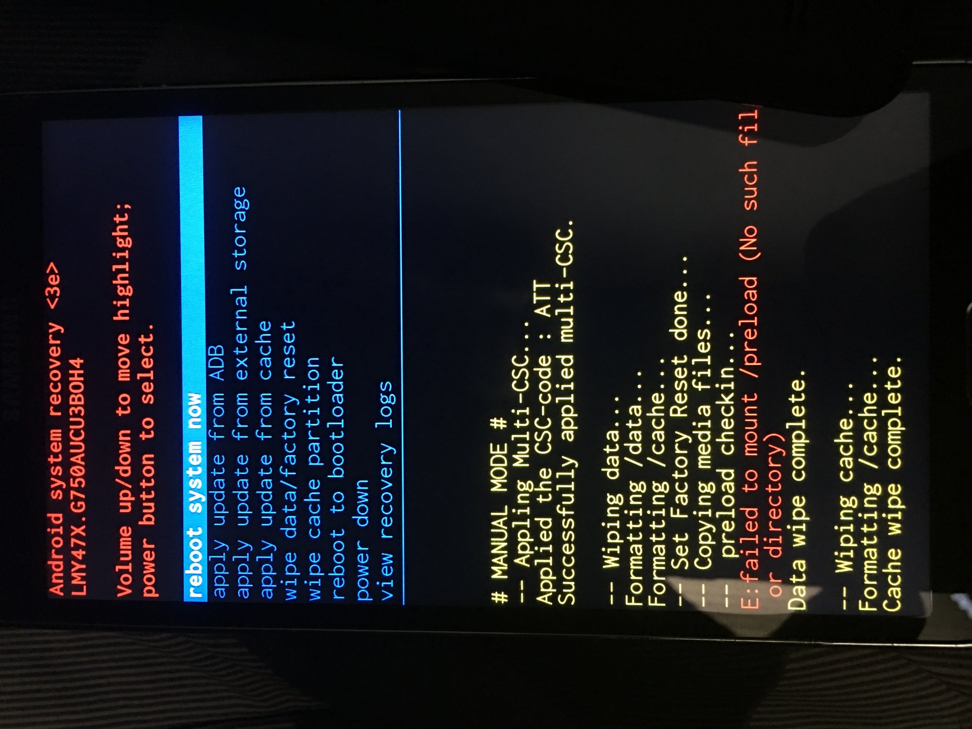

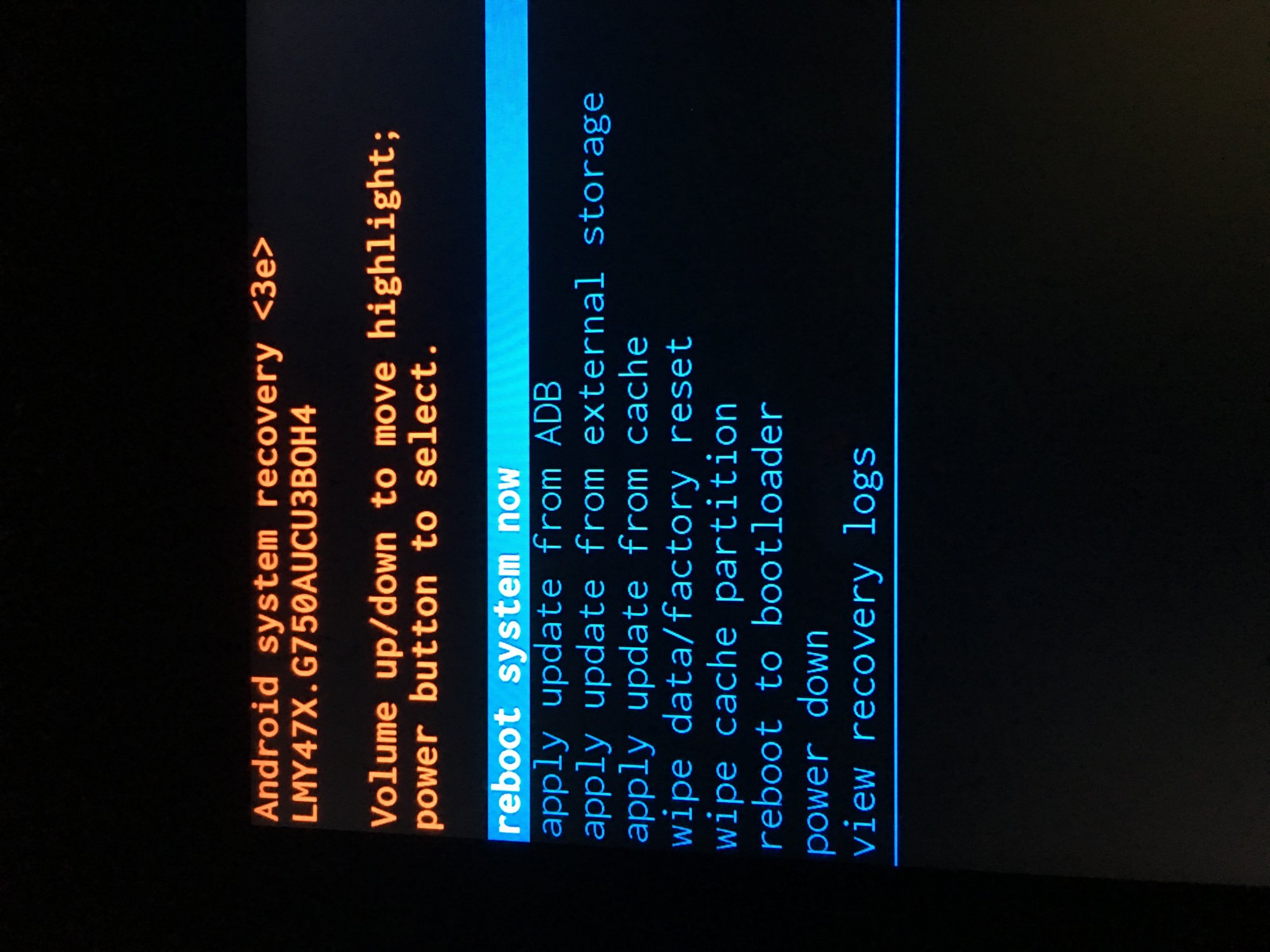

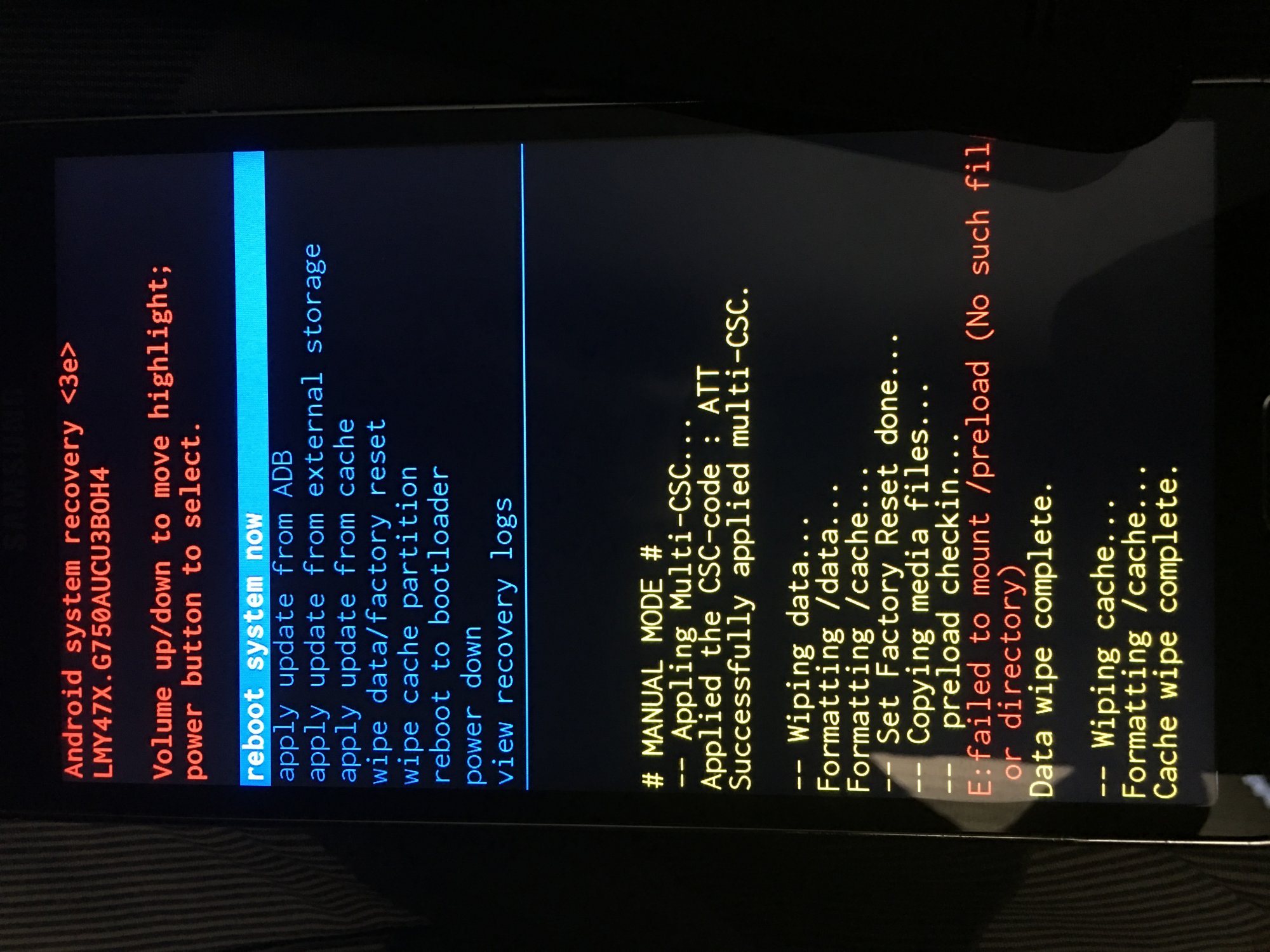

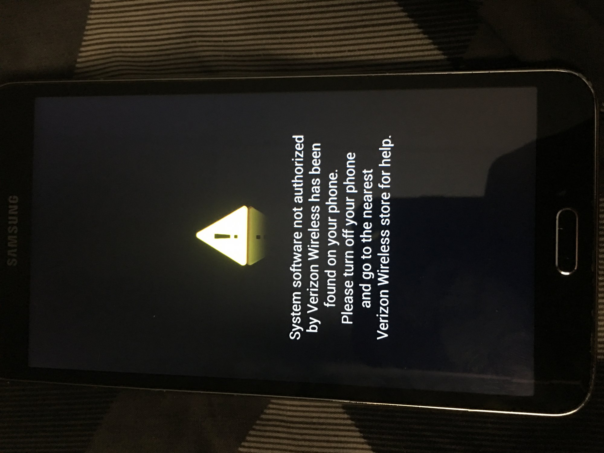

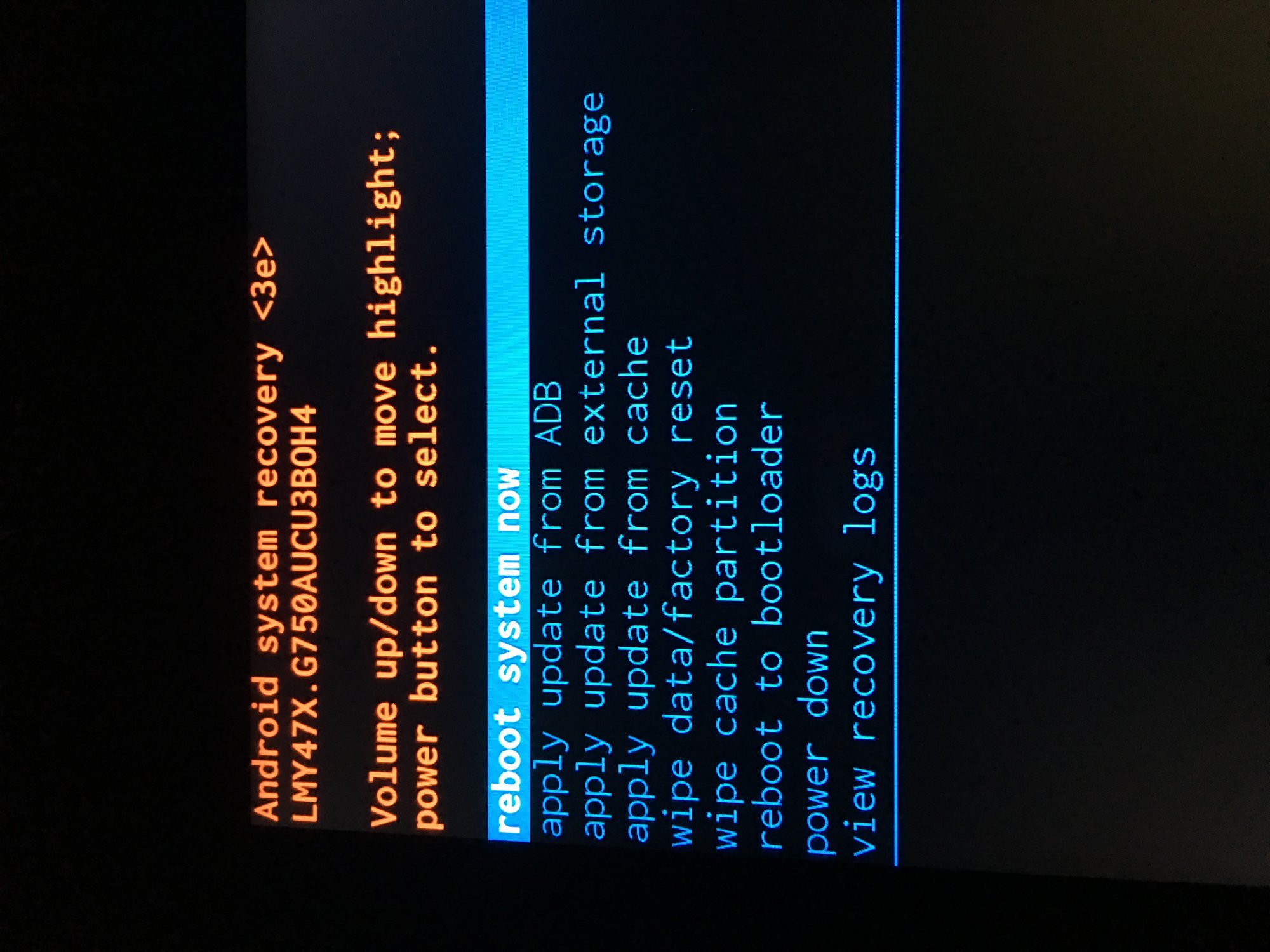

ok I have a Galaxy mega 2 I tried rooting it and it bricked it bad! Sent it to Samsung and they seen it was rooted so no help there took it to a cell phone shop and it won't connect to odian if that's spelled right lol and won't recognize it so how can I get the software back to the original way see pic for error message can anybody fix this

The image you posted, is that what appears when you turn on the phone or is that what is displayed with phone in download mode?

This is a ATT phone I don't know why anything of Verizon is coming on it Verizon never had this phone or even sold it ?????

If it's an AT&T phone, be interested to know how it managed to show a message about unauthorized system software on a Verizon device? Verizon have never sold the Galaxy Mega 2? Did you flash the wrong ROM or something?
