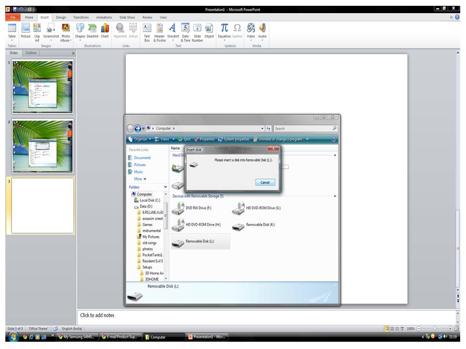

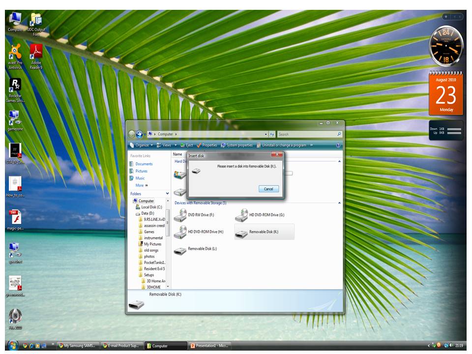

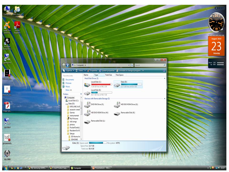

i am not able to connect my phone in usb mass storage mode.
every time i connect and try to open the drives, the explorer hangs and i have to restart my pc.
any suggestions guys
