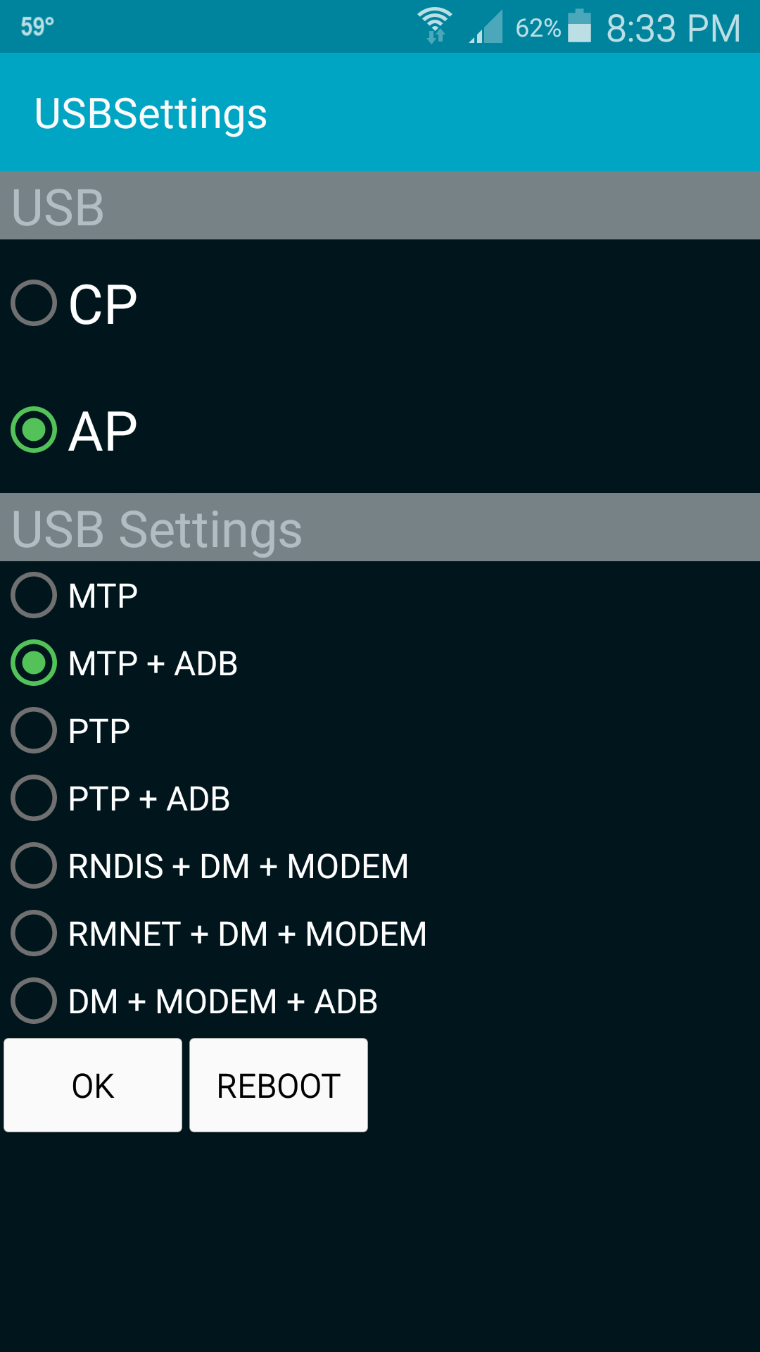

One thing that I can think of would be to check the hidden menu USB settings. On your phones keypad dial *#0808# to access menu. Settings should be AP and MTP + ADB. Note what yours is set on and change if needed. Press OK then use return to back out of menu or reboot option Screenshot_2015-11-10-20-33-46.png
One thing that I can think of would be to check the hidden menu USB settings. On your phones keypad dial *#0808# to access menu. Settings should be AP and MTP + ADB. Note what yours is set on and change if needed. Press OK then use return to back out of menu or reboot option View attachment 96671
Did that. Didn't work out. Any other ideas. It was working fine earlier....this problem started just a while ago....
OK.. What am I doing wrong?. If I enter that code nothing happens and if I hit the dial button I get a message saying the call cant be completed. What am I missing?
What model S4? If it's Verizon i545,they lock the hidden menu. You have to be rooted and make a change in EFS folder to be able to use keypad codes.
