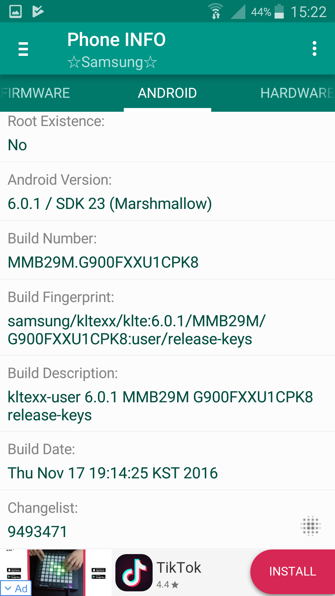

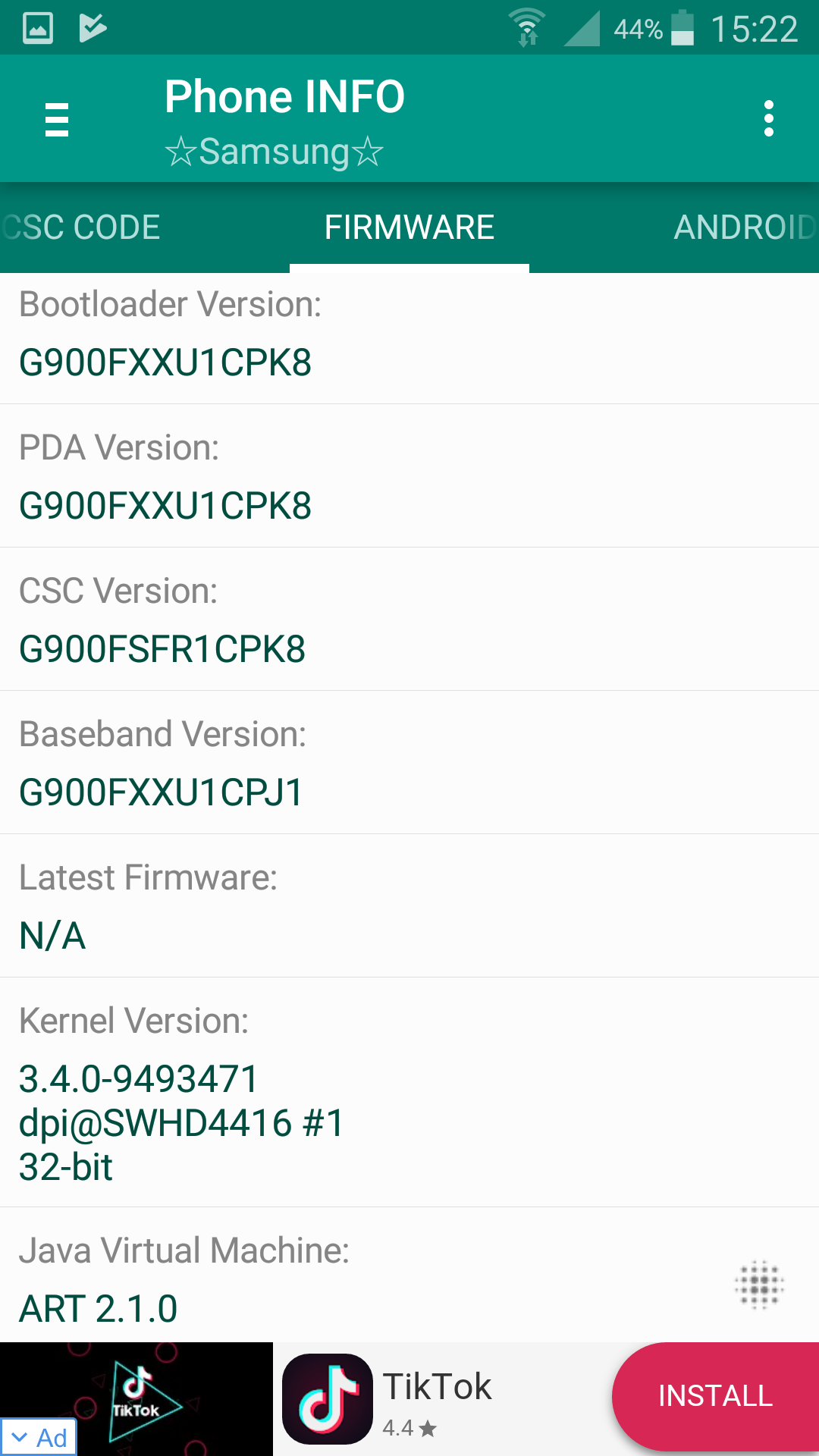

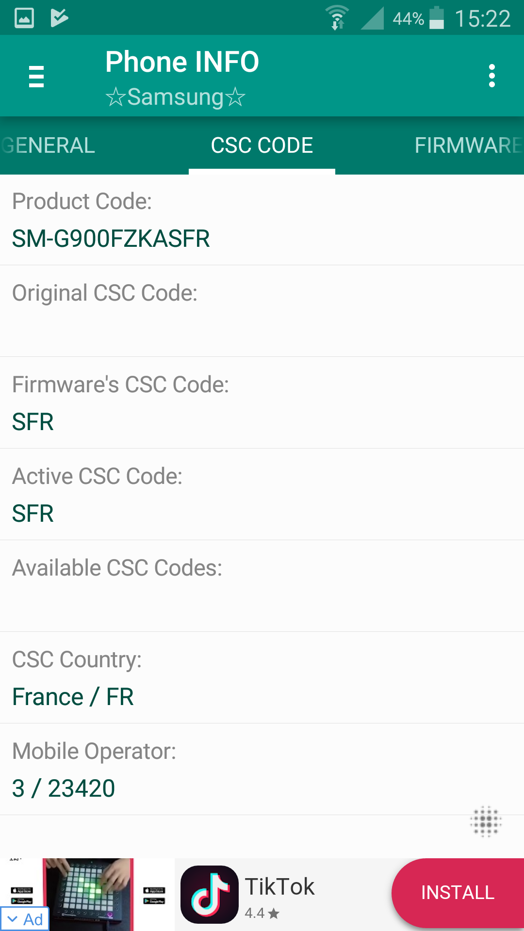

I did have another thread with what has been disguised as a heinze 57 phone . Stuck on 5.0
I've now had this changed although it was a French phone
All OK
Running 6.1
Wondering if there is any other update I can apply ?
Also phone info states as original
Thanks
Dave

Since the Galaxy S5 is no longer supported by Samsung, the latest stock Samsung firmware is Android 6.0.1. However.you can flash the unbranded, non carrier, version of Android 6.0.1 for the United Kingdom by using the Odin PC suite. If you want later Android ROM, you will need something like Lineage that I linked you to in your previous thread.
Download firmware...
Model SM-G900F
Model name GALAXY S5
Country United Kingdom
Version Android 6.0.1
Changelist 14131106
Build date Mon, 06 Aug 2018 10:17:28 +0000
Security Patch Level 2017-08-01
Product code BTU
PDA G900FXXU1CRH1
CSC G900FOXA1CRH1
Flashing stock Samsung firmware will cause you to lose root.
Hope that helps. I am travelling at the moment but the video and its links should cover everything you need.

LINK SENT now downloaded and flashed with odin
simples :)
phone now on android is upgrading
advice and helpfulness on here is excellent thank you
