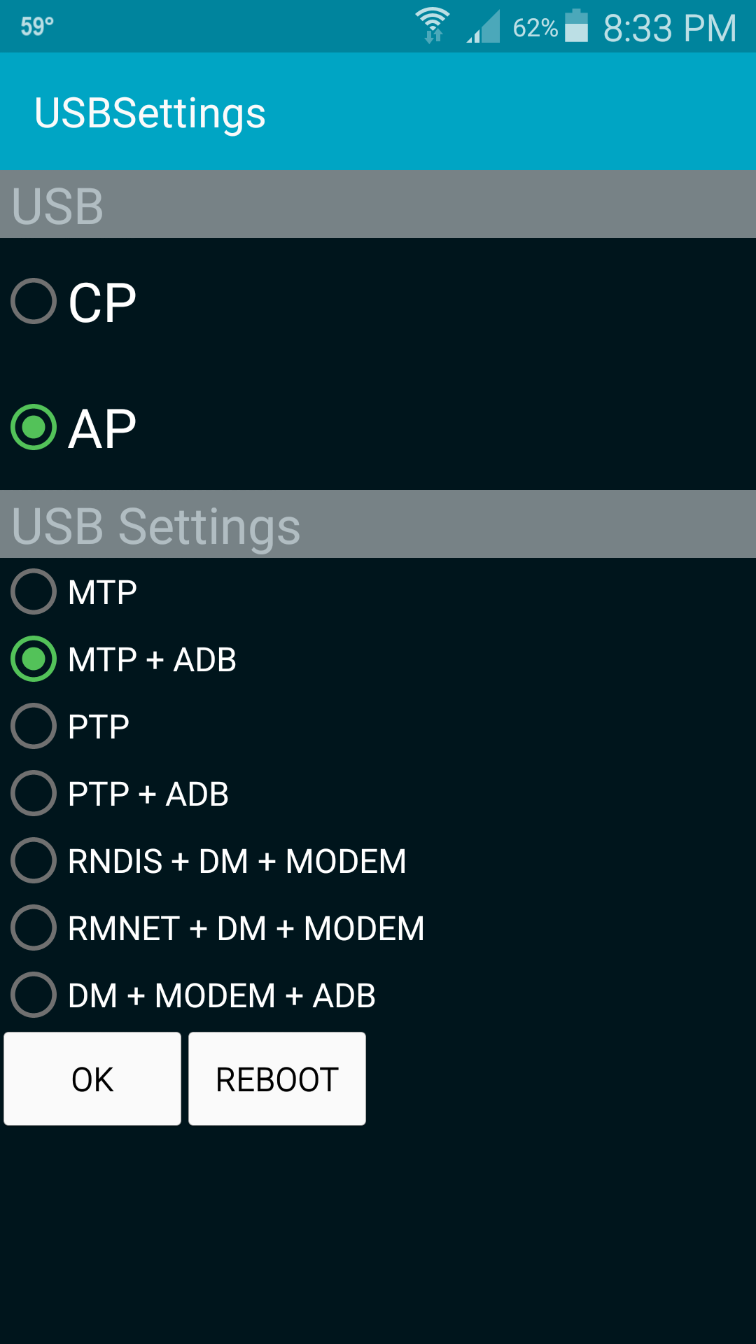

Have you looked at the hidden menu USB settings? Pull up the phones dialer keypad and enter *#0808#
Should take you to the USB menu.
MTP+ADB should be checked. This is what it looks like on S5
inputting that key combo in the galaxy S6 didn't do anything but I access that similar USB options when I activated the developer mode in the settings. I've already made sure it was set to MTP and or ADB
Didn't know you had the Verizon branded model. Verizon blocks access to hidden menu settings.
