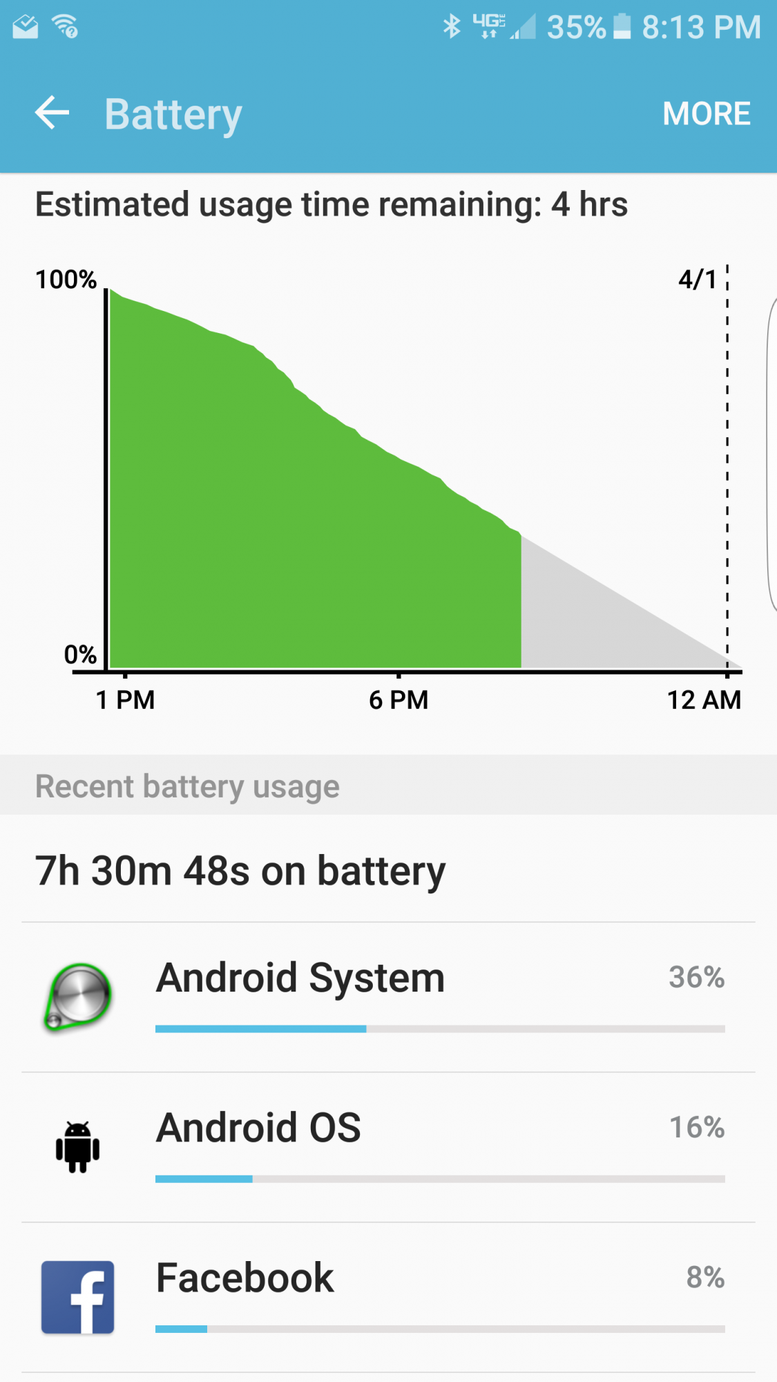

I feel like going from a full charge at noon to 33% at 8:30 with very little use isn't all that great. Should I expect better?
I posted the screenshot of battery use - it's been over 40% Android System eating it up, and over 15% Android OS. I keep my screen very dim. Last night I had it fully charged at 1:30am, and I didn't touch the phone once until noon - it had drained to 51%. So there was zero on screen time on that one.
That's way out of line. I can keep my phone off for 12 hours and only lose 8% of battery power. I have the US version that supposedly utilizes more battery (defamation suit already filed against ironass). Don't go by android system usage as many apps/activities can affect it.

I would suggest downloading an app called G Sam Battery Monitor and checking it after the sleep period. It could help identify any offending app/service that is causing this battery drain.
Thank you, I will download G Sam it and see exactly what's going on. It wasn't using much battery when I first got it (and I had all of those things on - Bluetooth, location, etc). I've downloaded zero new apps - the only thing that changed is the there was some software update about a week ago. I believe it was a Samsung update. It's been less than stellar ever since that. I'm really not sure if there are any prominent notifications during the sleep period because...well....I'm asleep :) I appreciate everyone's input. Other than this annoying issue, I love this phone - the photo quality is excellent!
Always a good idea after any firmware update, to do a cache partition wipe to clear any detritus from the phone's memory.
Thanks (and thanks for the video) - I just performed this and we'll see if I have any improvement!
Thank you, Ironass - that completely solved the problem!
OK, this solved the problem for a day. Android System now using 45-50%, even on Power Saving mode (dropped from 92% to 87% in 30 minutes in power saving mode with zero use, just sitting next to me untouched.
Everyone's usage and settings are obviously different, so the true test is how things compare to your own history. That being said, I cleared the partition as noted in the video above after doing the most recent T-mobile update and with a little less than an hour of SOT and 6+ hours of being on, my phone is at 84% with the screen now being the biggest offender. That had not been the case in the month since I got the phone, so I'm cautiously optimistic that at least one of the above changes helped the cause a little.
Most notably, it seems to be burning less battery when sitting idle. Granted, it's a small sample size so far.
