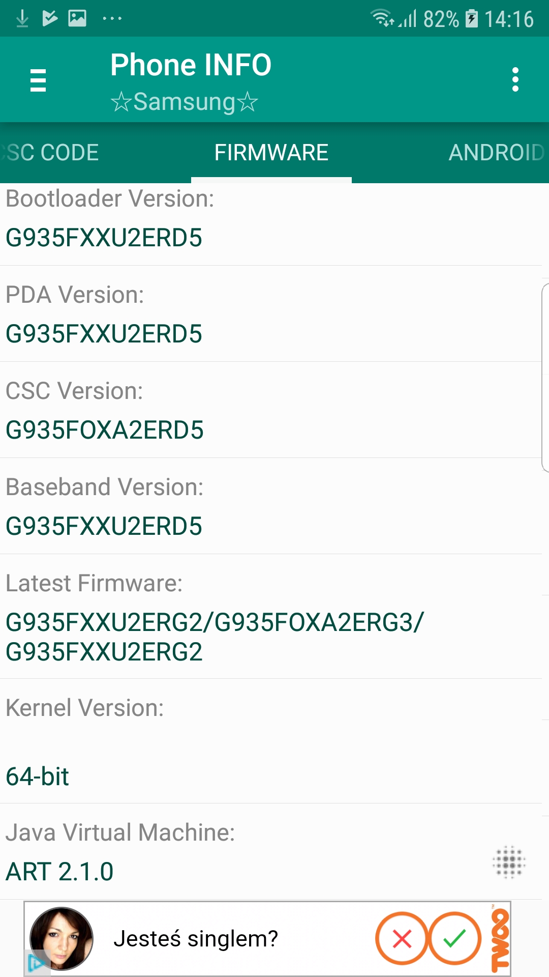

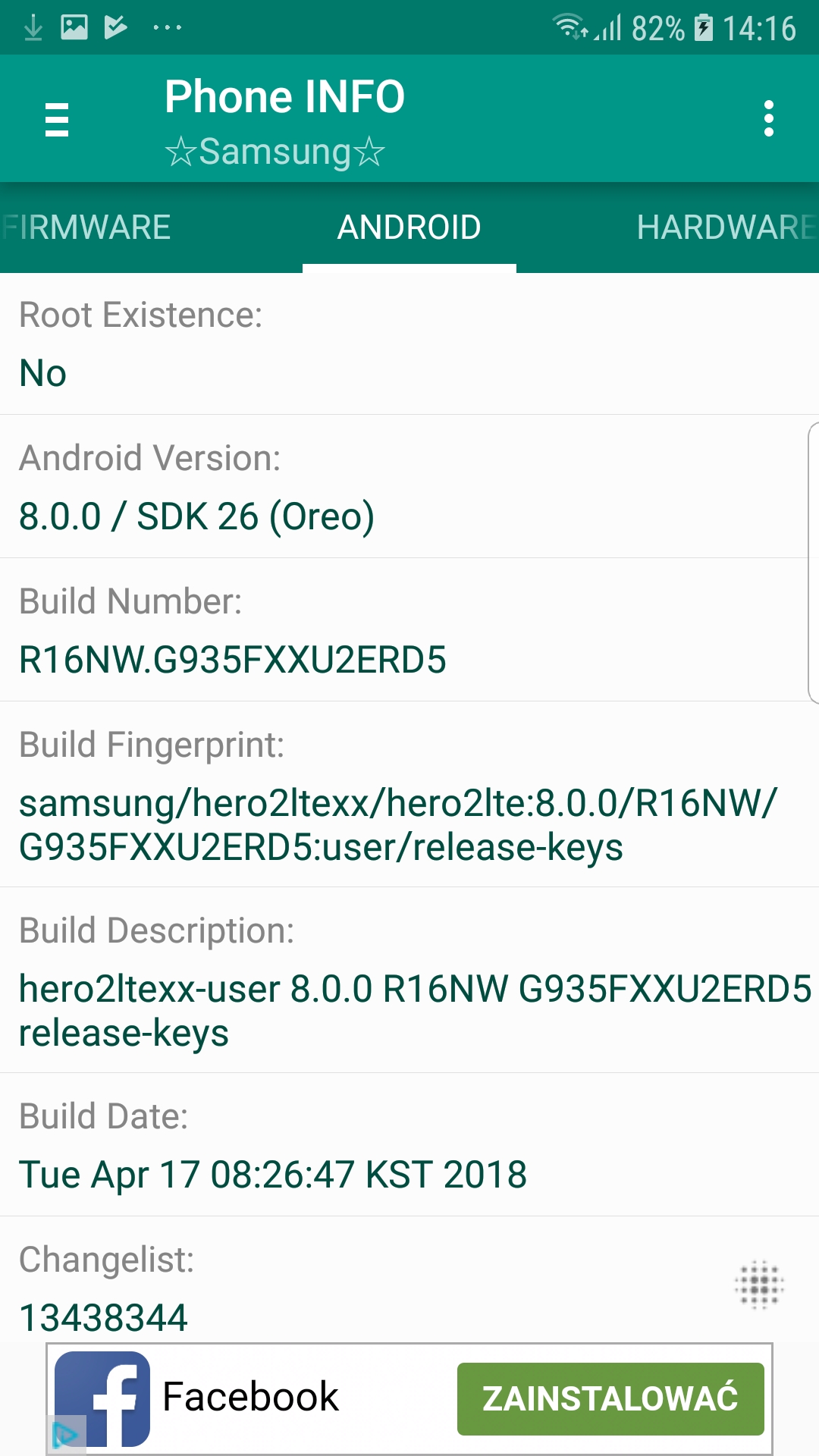

What's important, phone info started working and below are the screenshots:
I get the hero2ltexx product name which seems not like a samsung name
No original CSC code
Root existence: NO - - -> WTF?

Look at the bottom of the first screenshot. Knox Warranty 0x1.
Samsung may have made new changes to their security and if Knox is tripped, they consider the device modified even though you returned to stock.
