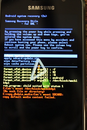

Today, my Galaxy will not boot past the "Galaxy S" screen on startup. I have read several posts with the same problem and I have tried all suggestions that I have come across. Here is what I have tried so far:
  1. Removed battery and sim card for several hours - no change
  2. Went into recovery mode (volume up + power + home button). Received a "E:Can't mount /dev/block/mmcblkOp1 (No such file or directory)" and "E:copy_dbdata_media:Can't mount SDCARD: copy default media content failed." error messages.
  3. In recovery mode, performed a "wipe data/factory reset" to restore the phone back to default - still no change
  4. Decided to try download mode (volume down + power + home button) and loading a factory image with Odin v1.3, PIT file 512 and I9000UGJH2. Selected "Re-Partition", "Auto Reboot" and "F. Reset Time" and Odin had indicated it was successfully installed - still won't boot and remains at the "Galaxy S" screen on startup
I should also mention that I found a post with the exact error message as in point 2 above. However, this was resolved by formatting the external SD card. I do not use an external SD card with this phone but I thought I would try one out anyways. I formatted the external SD card with my wife's Galaxy and tried installing it in my phone. It did not change anything so I don't believe this issue is related to an external SD card.

Hi Vampiress,
Ya, unfortunately I tried the factory reset in the recovery mode and it didn't seem to fix the problem.
Also, I am on vacation right now so I won't be able to return the phone another week or so. And, then I will have to wait for Samsung to repair it before I can use it again so I was really hoping to be able to fix it on my own...
