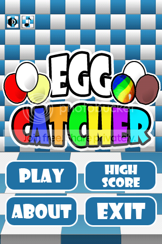

Main Menu

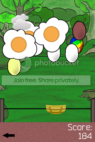

Game Screen

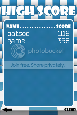

High Score

The menu interface looks good, and is easy to use. The in game controls are smooth, and easy to use once you get the hang of them.

The gameplay is pretty straightforward. It is entertaining for a little while, and does get more difficult when there are more egg blots on the screen. It does get repetitive rather quickly, and I think there are ways to make the game more interesting. A simple idea would be to adjust difficulty as the game goes on. The speed and/or volume of eggs could start out low and increase as your score gets higher.
-Graphics-
The visuals are simple, but certainly sufficient. They are fitting for the theme of the game.

The application crashes whenever I try to save a high score, and I have to force close to get out of it. When I relaunch the game, I am brought directly to the High Score screen, which contains no entries.

Thank you for your comments sir, about the issue in our high score. We are currently fixing it, we still don't know if it is about the compatibility issue of our game. :confused:
My partner, Pat Soo, already fixed the bug in saving the high score after the game. Here's the new apk of our game, hope you like it!!! :D:D:D

Also, I'd suggest a cancel button on the high score dialog. Sometimes players just want to get back to playing the next game without entering their name. Again, it's just a suggestion. Good luck with this project!
