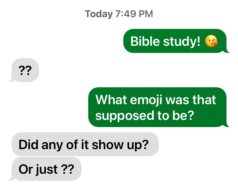

I keep getting this error where I sent a message with an emoji and get another text sent with "??" as shown below:
AT&T keeps having me reset the network settings which does nothing to fix this and the Samsung customer support closed the call after the issue didn't present itself when we were troubleshooting the issue. I have absolutely no idea how to fix this other than reformatting my phone back to factory default and erasing everything. I seen there was a thread on this issue but can't seem to find it. Has anyone figured out this issue?

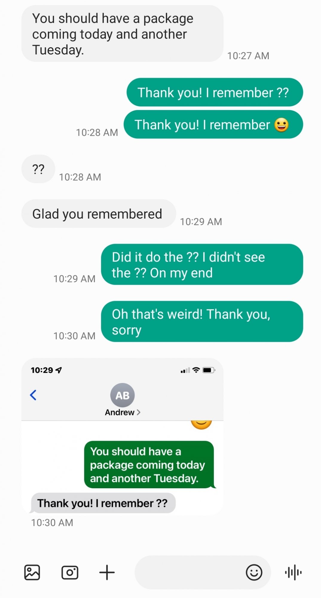

So it just happened again and I sent screenshots of the difference of what the issue looks on my end and outgoing. The person on the other end sees just the ?? but I see the emoji and the ??. I can't seem to find how to clear my message apps cashe. If anyone has some insight let me know.

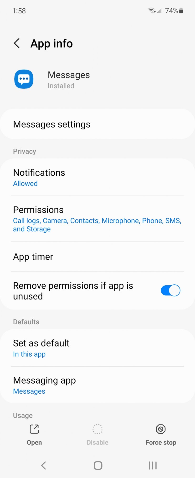

no.....go to your phone's settings>go to messages(your messaging app)>scrolled down until you see "storage">scroll down at the bottom. you will see options to clear data and one for storage
This is all the options I have.
this screenshot is for your storage overall for the phone. you need to go into your app manager:
phone's settings>apps>messaging>scroll down to storage>at the bottom you should see options to clear cache and to clear data.
Think it made it work different now. The ?? is in the 1st text and the emoji is below it. Reverse order. Still shows up ?? on receiving end. It did something clearing the data.

Something really huge I've found. This only happens when I send emojis to Apple users.
that is a very a likely issue. apple and android don't mix well. and it is usually when people are texting with one another......so i'm not surprised this is happening.
