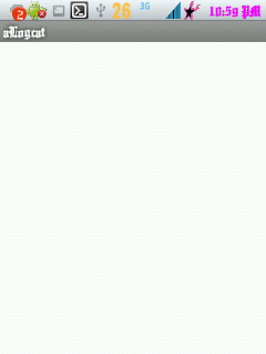

Good to know you put the smiley face i thought you be mad at me for some reason anyways back on to subject i got nothing i took screenshots to see if i am doing something wrong?
and i did also put alogcat filter at "sec_code:"
Thanks, the pics show you did it correctly. Did you try again with Terminal Emulator as well?
