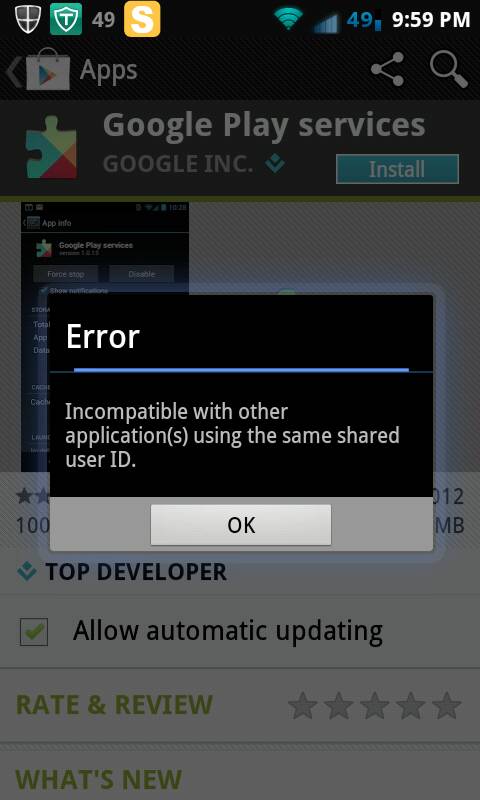

I try installing Google play services but I always get this pop up message and it never installs any ideas? uploadfromtaptalk1355205717179.jpg
I try installing Google play services but I always get this pop up message and it never installs any ideas?View attachment 45200
Yeah, I have the same problem. I updated the YouTube app from Google Play last night. When I opened it, a message displayed saying that I needed to install Google Play Services. When I tried to install it, I got the same error message as you.
I tried doing a factory reset and then attempted to install Google Play Services before I restored any apps, but no luck.
Just for reference, my version of Android is 4.0.3 and my tablet is an iDeaUSA YG A777.

here, I had to resign it to work with CTMod: com.google.android.gms-2.apk
just throw it in /system/app on your phone and reboot then you'll be good.
This worked for me. Thank you, Bloodawn!
As a side note, once you move com.google.android.gms-2.apk to the /system/app folder, you still need to install the package. Another way you can do this is install the package from any folder and then use Titanium Backup to convert the app to a system app.

Here is the error before I did you what you said.
"Incompatible with other application(s) using the same shared user ID"
When I copied the version of Google play services you put up here it says "An Error Occurred"

something you guys can try is:
and of course make a backup in CWM before you do this
1) delete/uninstall that play services apk I linked before (com.google.android.gms-2.apk)
2) download and flash this: Goo.im Downloads - Downloading gapps-gb-20110828-signed.zip
3) after it flashes wipe dalvik cache and the cache partition
4) boot up and open the Play Store, it will have to auto update itself to the newest version
5) once thats done go to My Apps and update all the google apps
then try opening youtube, it will probably ask you to install play services again, do it and see if everything works now. if it doesn't it might take a factory wipe and require redoing steps 4 and 5.
edit: i just did all this on my marquee and it required the factory wipe to get everything working right, youtube is fully updated and working now.

No luck. I tried doing steps 1-5, but I still wasn't able to install Google Play Services from Google Play. I then did a factory reset and repeated steps 4 and 5, but, again, no luck.

Worked for me, are you sure you had the old app deleted before you did the factory wipe?
Try flashing CT, after its done flashing go to advanced in cwm and do reboot recovery, flash gapps, boot up normally now and try everything out.

Unfortunately, ClockworkMod isn't compatible with my tablet (iDea USA YG A777). I actually had to flash gapps by booting into stock recovery.

So your not using a marque? If so that's why none of my steps worked for you.

Ah, I see what you're getting at. I didn't see that this specific thread was in the "LG Marquee > Marquee - All Things Root" category. I only came acrossed it through Google while looking for a solution to Google Play Services not installing. Oh well.

boot into CWM and do either a factory wipe or reflash your rom
after thats done go to advanced in CWM and select reboot recovery
boot up and log into your google account, the Market will have to update itself to the Play Store I think
once thats done open it up and go to My Apps and update all the Google apps
now you can install YouTube/Google Play Services and everything should work fine.

:rolleyes:I just cleared the cache and it immediately worked! (Go to...Application/youtube/clear cache)
