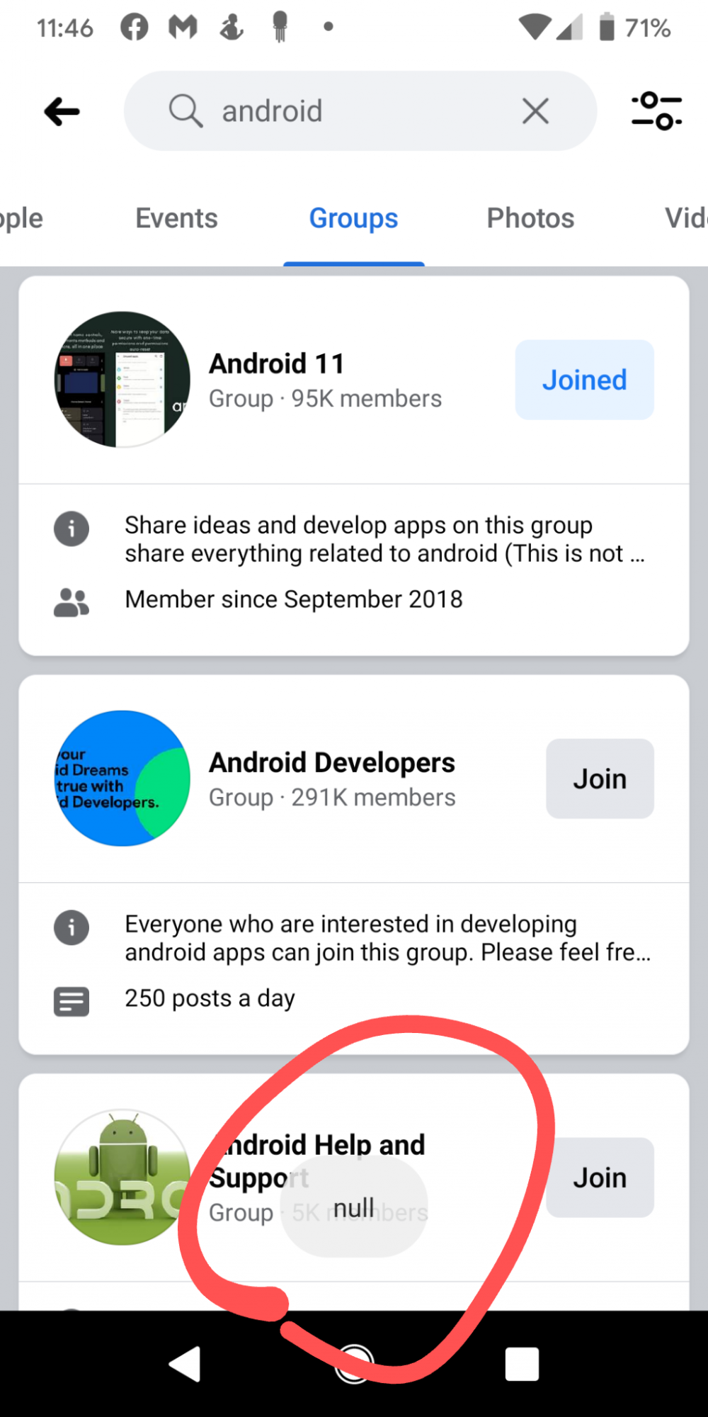

I keep getting this 'null' notification since my update. What is it and how to remove please....
That's got to be generated by one of your installed applications. You can verify this by booting your phone into Safe Mode (which disables your installed applications) and watching to see if the toast appears again.
Do you use Firefox Lockwise? I've seen a few folks mention that it might be the culprit. Try disabling it as an Autofill service to see if the toasts disappear.
Problem solved I went straight to the input menu on system settings. Kaspersky password manager was selected for keyboard autofill. I switched it to gboard and it has solved the problem.
Thank you anyway 👍
It's probably related to the fact that "custom toast messages" were deprecated in Android 11. Any app that used such a thing and hasn't been updated will now generate "null" toasts until it is updated to remove them.
Oh, good info! I was trying to figure out why my Bitwarden password manager wasn't causing me to get these toasts since it did appear to be tied to the autofill service.
