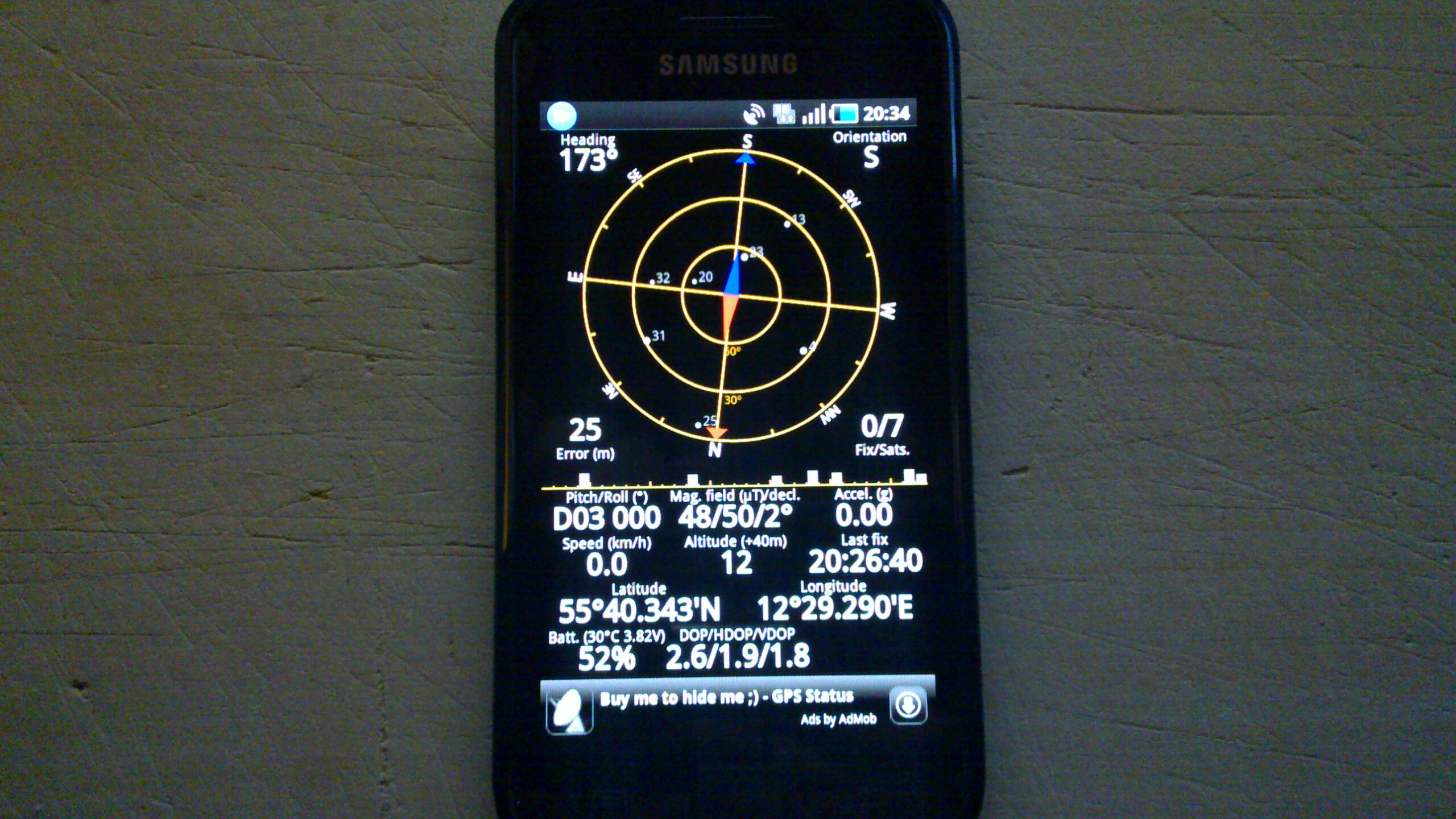

Well regarding the GPS
I tried Faster fix got the black screen, reinstalled busybox, still black screen restarted phone and voila' started up fine... Well I't did something... now I can see 6-7 sats but it still won't log on to any. One time it did for about 2 seconds and that was it... Sats are stil visible but it won't get a fix on any of them. :(
I'm thinking about Making a backup of stuff, and then doing a factory reset if that might help... (It can't get any worse) ;)
It just stays like this and doesn't fluctuate alot like before but it doesn't get a fix and thus can't determine a location.
