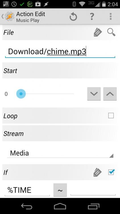

I think the correct variable is %TIME...I guess the condition operator is Matches...don't know what to type after this.
