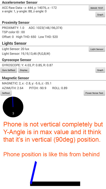

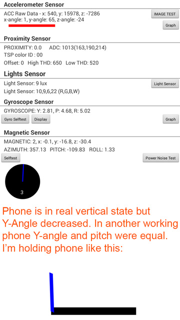

When I hold my phone vertical (portrait or landscape) to take panorama or photosphere photos it's out of alignment and I have to downward it to the earth to adjust the horizon line to the middle of screen! In another word if I hold my phone in ~80° its sensor behave like it is in 90°. Attached photos shows the problem. I have rooted my device with official 4.4.2. I couldn't find any helpful guide about how to initialize or calibrate accelerometer or G-Sensor. rotating phone in 8 path, rotating around all 3 axises, restarting device didn't help.
Please help me how to solve this issue. I don't want to reset factory device right now. I've access to all system files if needed. Thanks

I had tested similar apps like bubble level, GPS Essential, GPS Status, Compass, .... I also tested this one now, No difference. :(

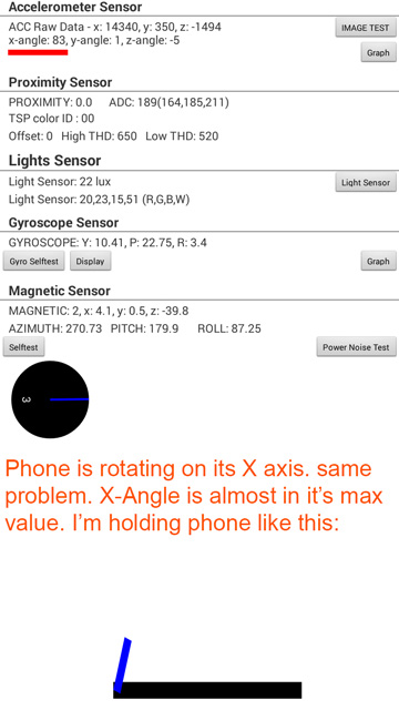

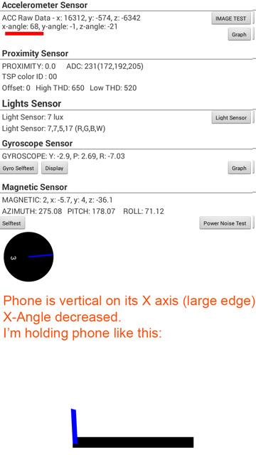

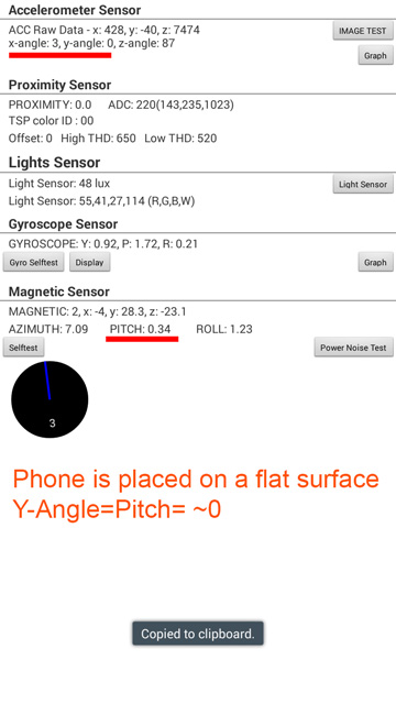

As I remember it has fallen 2 times 1.5-2 feet! New photos are showing what is happening exactly. I also tested what you suggested.
