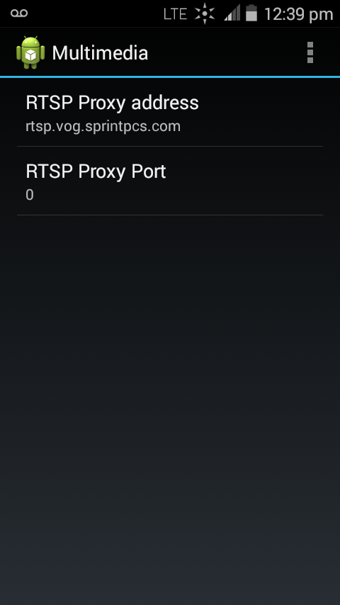

I did all of this. I CANNOT find http proxy or http ip. It does not exist. Customer service said they couldn't change it for me. How do I change them? ZTE Speed, no root.
