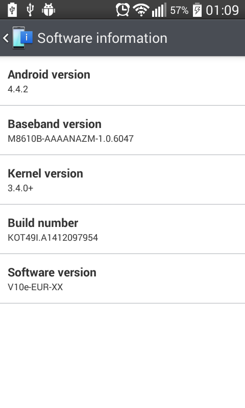

Hi! I have a LG L70 (lg-d320n) updated to android 4.4.2 and towel dosen't work. Can you give me.some advice? :D

This is everything about its software. Do I have to downgrade it??

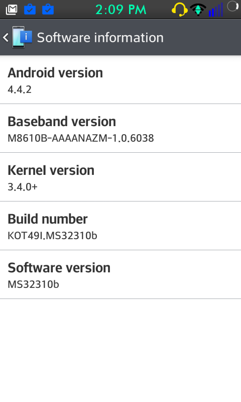

OK here is my problem now.
in the past 3 weeks i have received 3 updates from metro piece of shit
ive had my phone rooted with towel root in the past.
i had to hook my phone up to lg site and reintall there software again
now when i try towelroot geo its saying im not supported
screen shots included....... for build info
did metro patch this or disable this app
please help

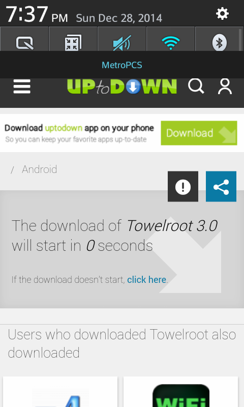

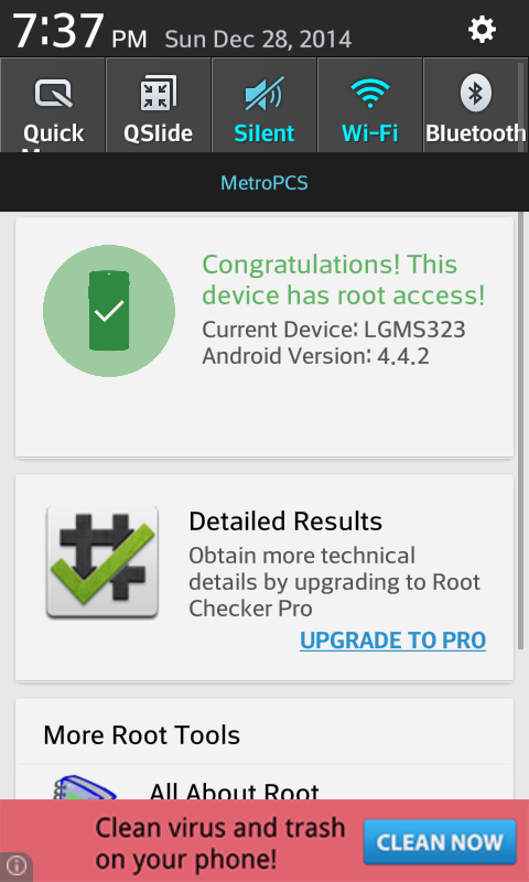

Ok now,
im on firmware b. And towelroot .... geo
is still not working. My phone is factory reset after i went back to b version. I have everything b firmware
Ok i think i found the problem. For some reason the towelroot by geo., isn't working after you go back to. Version b.
The version of towelroot that i found that works is available here
http://towelroot.en.uptodown.com/android/download
Ill send a current screen shot. Proving im not lying as alway. Time and date stamped.
Thanks for the help hope i can help someone else

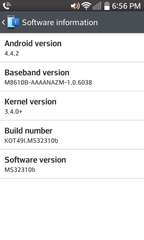

Can you help me out? I did everything in the instructions and it's telling me 'This phone isn't currently supported.' My phone is an LG Optimus L70 running 4.4.2 KitKat. Build Number KOT49I.MS32310c
Said it wasn't compatible with my LG 70
Go to settings, then click on general , scroll to the bottom and click on about phone, then click on software information and it will look like this but if you have the ms32310c on the software version then you will have to flash your phone back to the ms32310b
