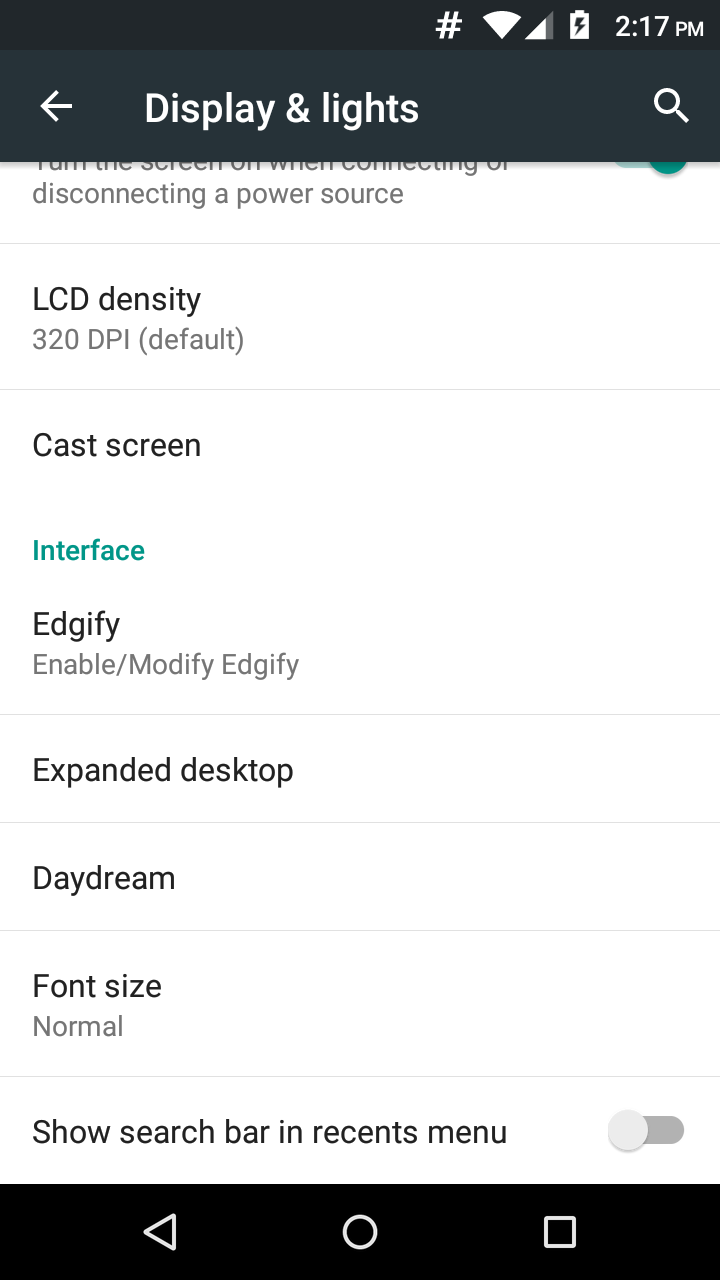

This is what I was working on all day yesterday. My new feature called Edgify, which is a clone of the Edge Screen for the Galaxy Edge devices. Still implementing the GPS lock which should be completed soon
