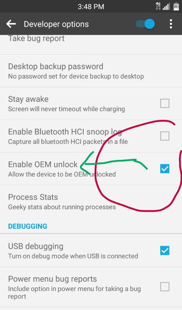

Make sure you have OEM-unlocked checked in Dev.mode settings. Sovit can work
