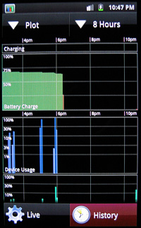

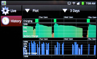

Last night my phone lost all its battery charge, apparently instantaneously (see SystemPanel plot1). On recharging the phone came back to normal (plot2) but this has been happening for the last few days (plot3).
What is going on? As there is no recorded CPU activity and it is unlikely that this constitutes real instantaneous battery drain I myself think that the battery is not calibrated. I would have thought that 3 charge drain cycles would have allowed calibration.
Should I do a factory reset (the third since upgrading to 2.3.3)?
Should I get a new battery?

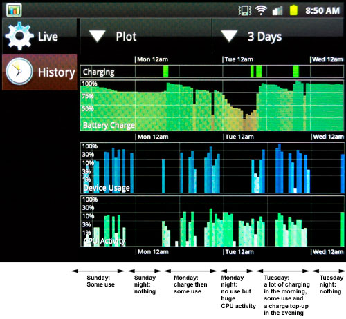

My phone has settled down a bit but does do some unpredictable things. The attached annotated screenshot of SystemPanel monitoring shows normal battery usage overnight Sunday and Tuesday but Monday night there is huge CPU activity which depletes the battery.
Running 2.3.3, 3-mobile UK, stock. For the whole period WiFi on, Background data on, one ActiveSyncing Exchange account and two IMAP accounts on 1hr check, autorotate on.
