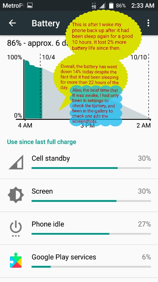

Help! My battery is discharging faster and faster...it's been only a month and a half now!!!
My ZTE zmax pro's battery is discharging faster than it has in the first few weeks that I have had it...and I have only had it for 44 days!
At first(like up to the first three weeks) the battery life on this phone was the best thing about it. I would charge it to 100%, then if I didn't use it like all day (24 hours), when I checked the phone the next day, it had only went down 2%!
On September 10th, I charged my phone to 100% in the morning, went for the whole day, used the phone throughout the day to make calls and texts, browsed the web a little bit, and by the time I got home, the battery had only dropped down to 87%.
Now, that was with my screen brightness in 45%-47%.
Also, I only had 3 apps that I had downloaded...4 now. None of those apps use up much battery power. Plus, I keep 2 of the apps notifications off ,the other two(games) rarely send notifications, and they(the games) don't run in the background. So, those are the only apps I have downloaded, all the rest came with the phone and they still don't use up much battery life.
Most of them I haven't even ran since I got the phone.
This is why it is so confusing to me how all of a sudden my battery life is draining faster now than it did in the first 3 weeks of me having it.
Can someone help me out here?
I already utilize most...if not all of the battery saving tips. I now keep my brightness down to 35-40%, I have wifi off, gps is off, and I don't really use apps.
I use YouTube, gmail(every once in a while), the two game apps, the music player, the video player (twice). I mainly use my browser and go online, but I don't stay online long. I also mainly talk on the phone and send text messages.
Here is another thing that gets me, in the first few weeks, I was able to talk on the phone for more than 2 hours without my phone dropping more than 5%, I could talk and text and briefly surf the web, and it wouldn't drop too much. I could watch a video without it dropping too much.
I timed it. Watching videos on YouTube in the browser or in the app makes the phone lose 1% battery life every 3 minutes. Watching videos on the video player app causes the phone to lose 1% battery life every 4minutes..that is reasonable.
Surfing the web causes a loss of 1% battery life every 3-4 minutes. Checking Gmail causes a loss of 1% battery life every 3 minutes. Checking and sending texts causes loss of 1% battery life every 3-4 minutes. That's fine. I didn't really mind that, since that has been happening from day one, and since I am actively doing something. When the phone wasn't active, and it was in sleep mode, the phone didn't discharge...not really.
Now, no matter what the phone is doing, it's discharging!
It discharges more now while it's sleeping than it did just three weeks ago.
What is wrong with my phone????
BTW, Up untill September 17th, it was discharging as normal. After that, the battery life wasn't the same.

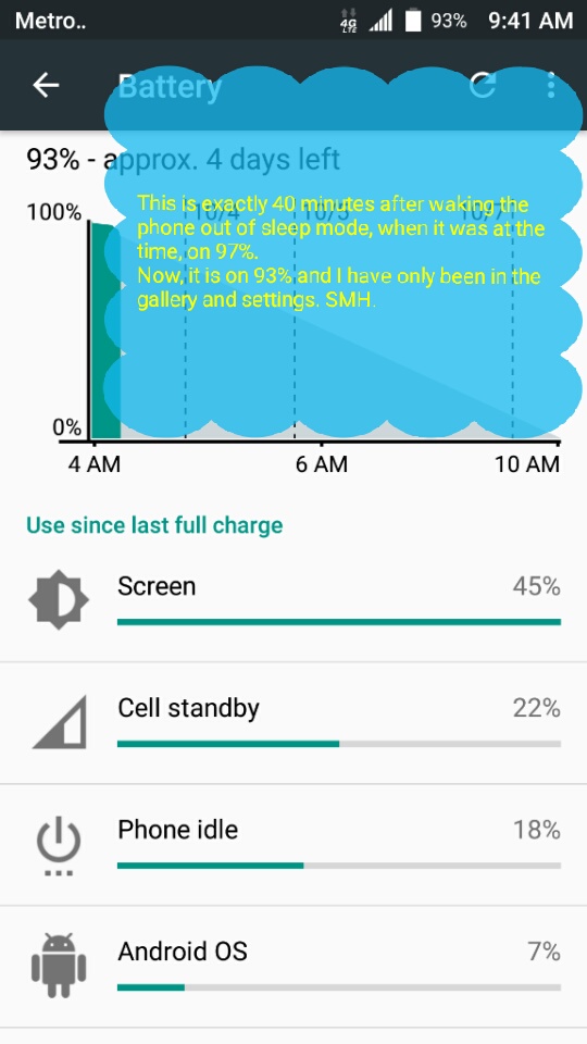

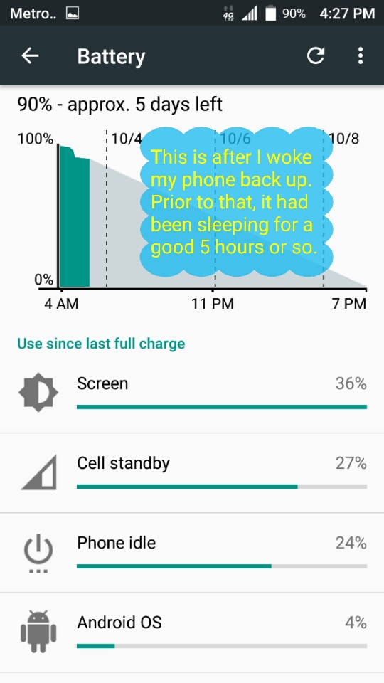

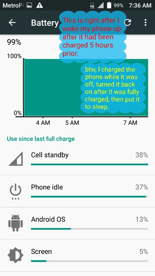

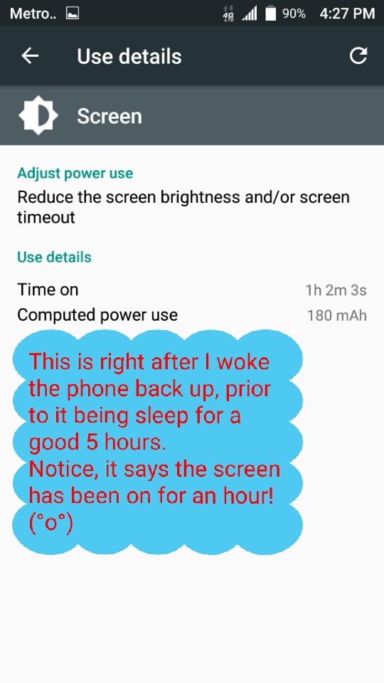

P.S. I am uploading screenshots that show what I am taking about. They will go in order from October 1st-8th.

Rogue apps? :-\ How do you get a rogue app?
I looked in my apps again, I still have all of the same apps my phone came with plus the 4 I downloaded. And no I don't have wifi, or scanning on. I pretty much have everything off.
I am uploading two screenshots I took just now. They show everything that is currently running. That's about how much is always running on here. I usually don't use too many apps at one time.

Sometimes if your phone has a security flaw and let's say you were attacked, malicious apps will install without the user knowing. I think android had a few, don't quote me on that tho.
I feel a factory reset will help, cause it does seem like your screen is staying on even tho it appears off. It could even be hardware related for all we know. If it continues after a reset it's hardware. Only way to know.

If cell standby is using that much CPU, then disable VoLTE in the call settings.
You can also try to retrain the battery. Charge fully, then discharge fully, charge to 100%, do for three or more cycles. Also maybe don't leave on a charger overnight, since it is a quick charging phone.
Also a theory of mine: try using a standard slow charger from a slow charging phone (1.0volts versus 2.0v or higher) with the usb-c adapter.

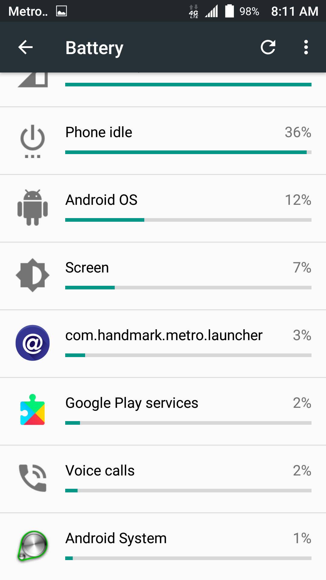

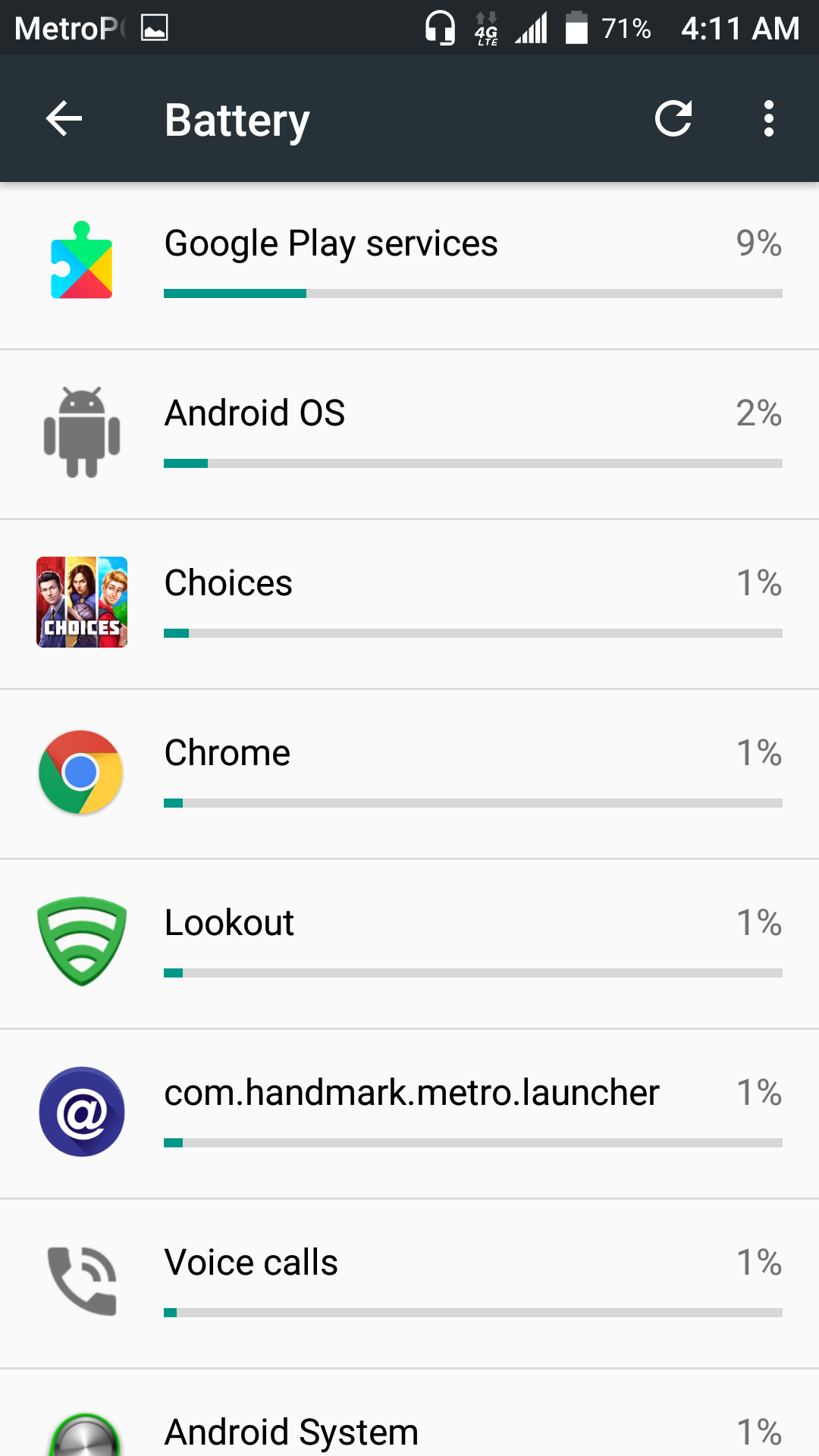

Okay so battery drain has become a true force in my life. It's been rather recent as well, as I haven't had any real problems until within the past month...
The 3rd screenshot is my biggest concern, because for this device's purpose RAM > Battery Usage.
Haaalp!

Can you explain what it is about the third shot that concerns you? Android is supposed to keep the RAM usage high: that's how it's designed, and is the most efficient way of operating (this isn't Windows 95, so forget any nonesense about free RAM being desirable). As for the power drain, it's hard to say: your screenshot shows a couple of very anonymous-looking apps using power, but I've no idea what those might be. Your signal strength isn't impressive: has that got worse lately? That could happen if e.g. a cell has been changed, and would affect power usage. Sorry that's nothing very definite.
