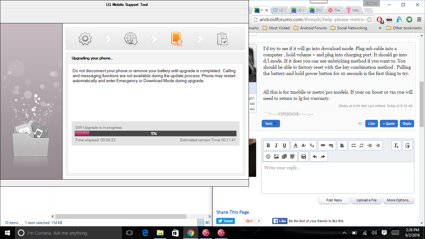

This where I'm at, it won't go past 5% tells me to unplug pull the batter out and try again. Also I'm not getting any response from the phone. Again I hear a chime from my PC when i plug the phone in. But nothing comes up on the screen. Any ideas.
Hmmm, try hitting Windows+R and type devmgmt.msc Or you can hit Windows+X and Hit the lettter m on your keyboard (Device Manager)
There look for any peculiar devices under "Storage Devices" or Unknown devices! If you find anything like QHUSB_BULK under Other Devices (I think it's something like that!) then you'll know that this is a hard brick, and with LG G series devices, there's currently no known way to recover from it
