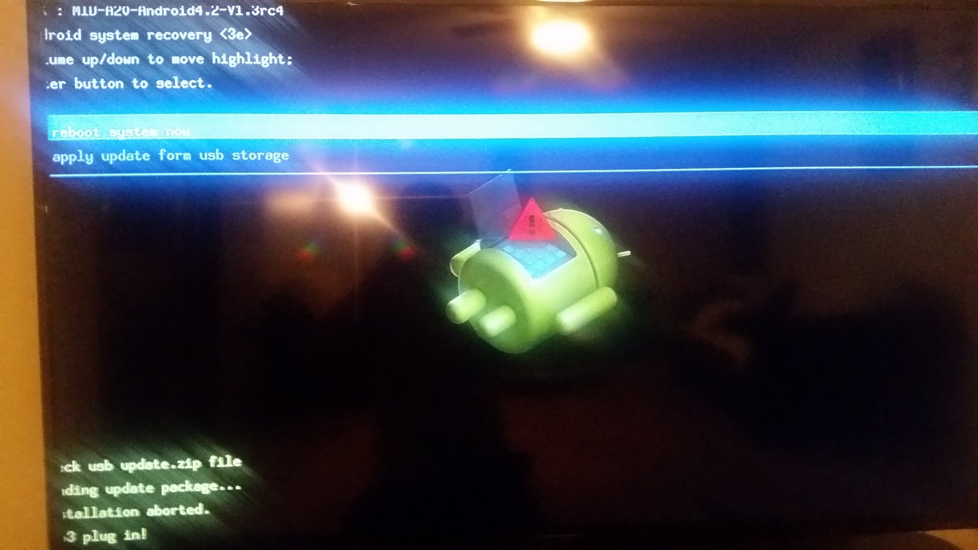

Hi all,
I really need help how to reset(factory) this tv box(
A10-A20WS Andriod 4.2.2os Dual Core 1080P HD Smart TV Box 1GB DRR3+4GB Nand Flash Streaming Media Player Android TV Player White)
here some pictures
Please help me
Thanks

thanks, but I dont have that screen ...here is what i got when i plug in
from here i dont know how to move forward

Hi... I've only just joined this site so you've probably sorted this by now but if not here is the answer to your problem.
First unplug your power lead
The reset button is located in the A/V port on the back of the device.
Using a small screwdriver or tooth pick, place it into the port until you feel a click
Hold the reset button down
Insert the power cord while continuing to hold the reset
Once you see the android robot, it is then safe to release the reset button.
Hope this helps.
Have you tried downloading and flashing the firmware for your box.. make sure you get the right build number for your box before flashing the firmware. Try this site it's where I got mine from.
http://chinagadgetsreviews.com/down...tkat-4-4-2-stock-firmware-for-mxq-tv-box.html
If this isn't your firmware then goto top of page and check through all the others they have.
Also you will need to make a bootable sd card to put the firmware on to first. Try this site follow instructions.
http://chinagadgetsreviews.com/how-...-bootable-magic-micro-sd-card-in-minutes.html
Got everything I needed from this site worked first time, so again check you have the right build number before proceding once you have your bootable sd card with your firmware then follow the instructions I said before but with your sd card inserted first.
Hope this helps.
