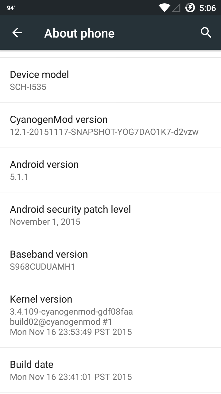

The S968C is basically the i535 with a unlocked bootloader. Everything custom for the i535 will work on the S968C, TWRP and Roms.
This one I installed CM12.1
I don't have a active Sim for it so could not check cellular data but everything else was fine.
Notice the baseband

Think of the ROM as the device operating system, Android version.
Part of the process of obtaining root that I use and recommend is installing a custom recovery, TWRP.
The custom recovery allows you to make a backup of your current system (Nandriod backup) that you can restore if/when needed.
Backups are your best friend and I save mine to SD card and also copy to pc.
Stock firmware can be found at Sammobile and installed with the Samsung flash tool called Odin
http://www.sammobile.com/firmwares/database/SCH-S968C/
I think there are two versions of stock, MH1 and MH2
Check in Settings -ABOUT Phone, and look at your build number and baseband version, last 3 characters, and see what you have
