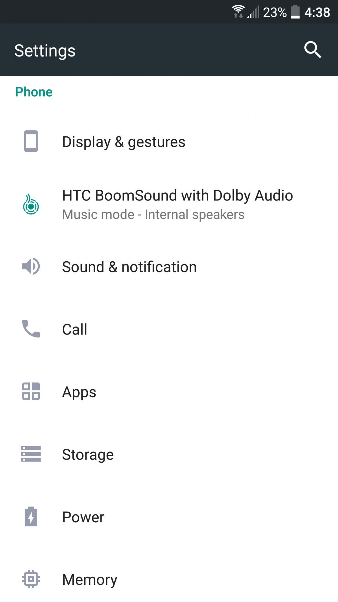

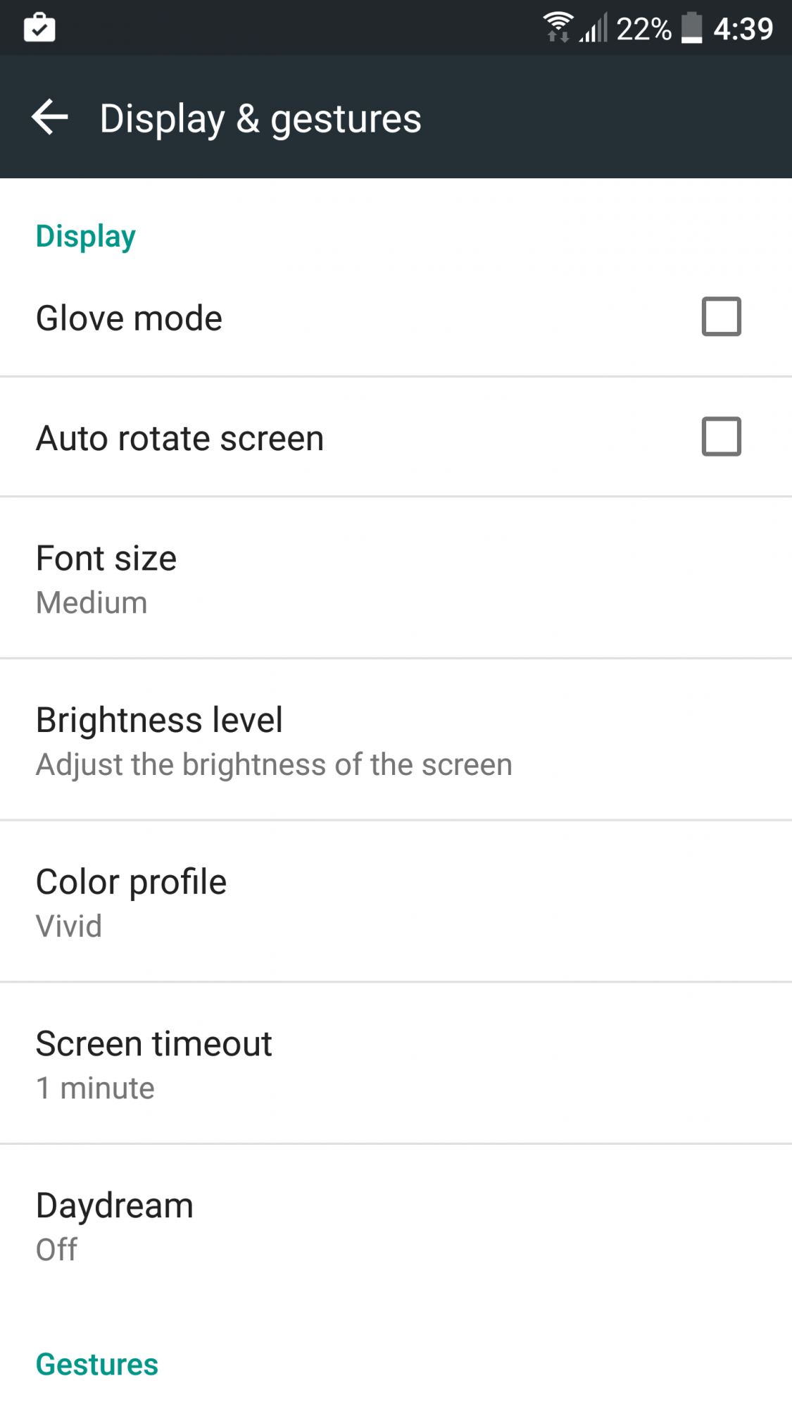

Hi all, the same problem just happened to me. turned off phone and even did a factory reset to no avail. i also realised that in the settings menu the option to toggle for buttons has also gone. it now says "Display & gestures" rather than "Display, gestures & buttons". any ideas? everything else works just fine.

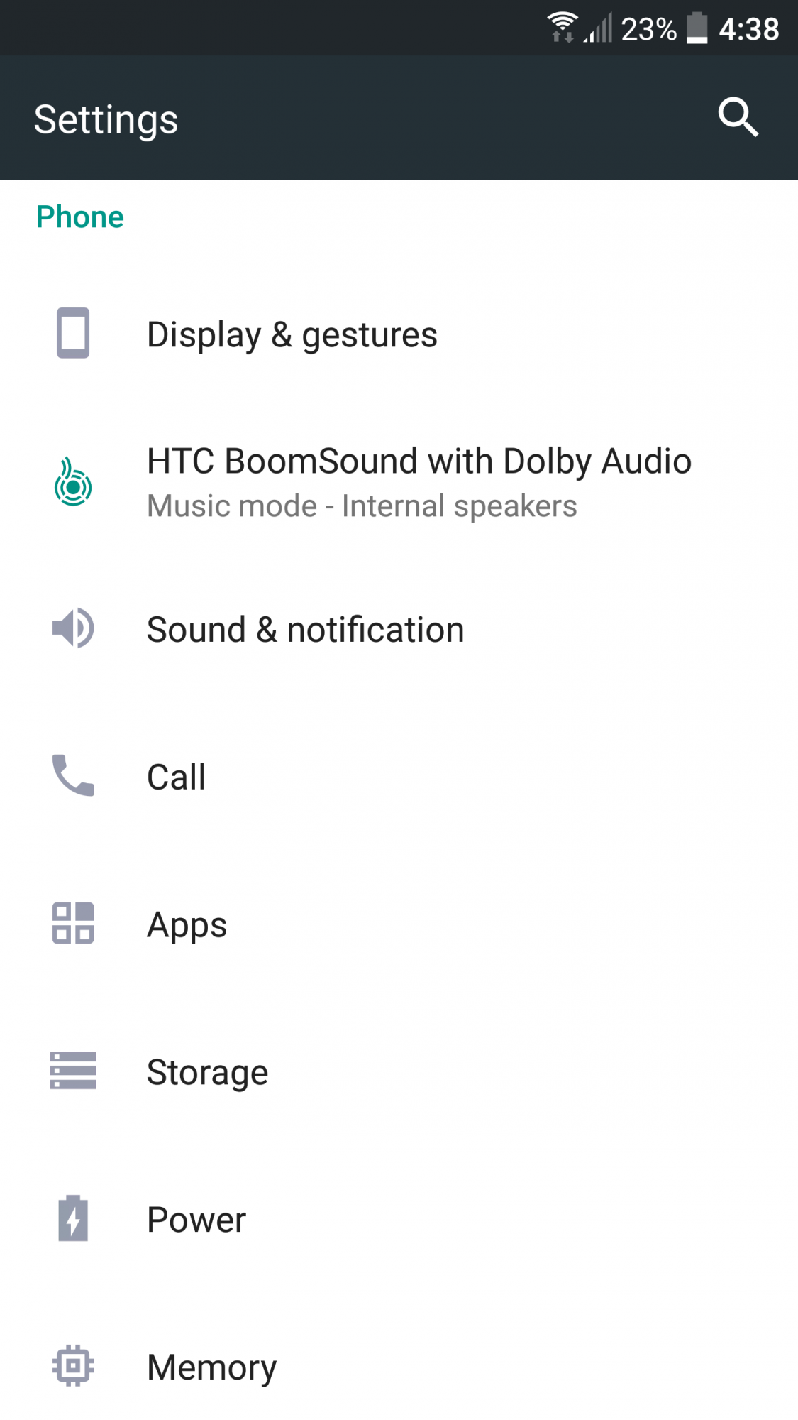

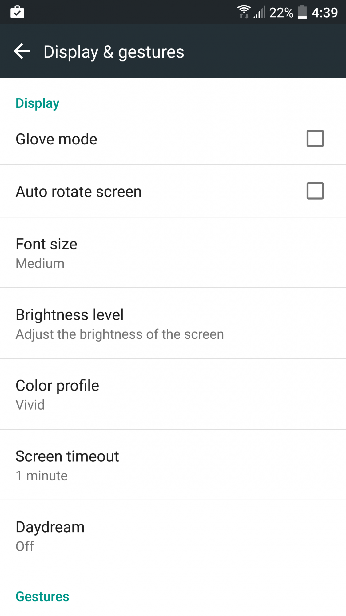

View attachment 106558 View attachment 106559
So the buttons just don't work at all? Take it back to wherever you bought it, they should replace no questions asked.
I just checked, I still have the 'buttons' option.
What carrier are you on? Did you get a security update recently?
