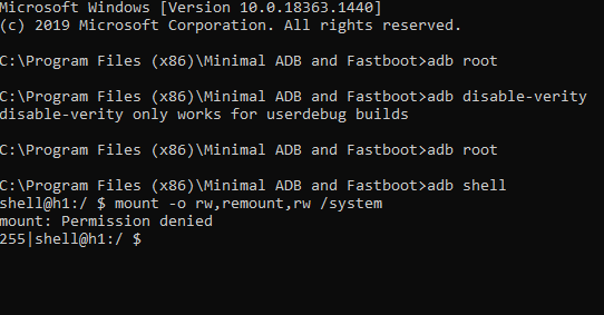

Everything works for me up to the point where you have to do adb disable-verity. This is the point after step 2. I know that step 2 works because the RUNMEFIRST dialog said to proceed to step 2 as it is supposed to say. Its just the next step where I have to do adb root and disable verity does not work. I know that it didn't work because when I tried the last step, then permission was denied, which meant that something did not work.
ADB says that it only works for user debug builds. Does this mean the user debug build was somehow not installed when I tried to install it through this? Everything up to the part where the prompt comes up to say to go to step 2 proceeds well. Maybe it didn't install the user debug build when I factory reset the phone for step 2? Does anyone know what I should try doing?

Yes, I do have usb debugging available on my phone. I was doing the adb commands on my computer also, I opened adb on my computer to do the commands.
This is the screenshot of the adb commands and prompts.
