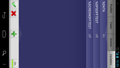

Edit 2: Would you happen to know what the variable would be for If Mobile Data off?
lol I know that part, but what would I have to select to create a new variable to use under the 'If' option (such as %SCREEN ~ off)?
Yeah, as I said before, tap on the right-most tab (Variables) and then tap on the green plus sign at the bottom. That will add a variable. Call it whatever you want. Assign it a value. Then it'll appear as an if option.
Thanks for clearing that up. Isn't that only for placing a value with that variable though, like on or off? Would simply typing '%DATA ~ on' suffice under the 'If' option?
Once you create the variable, it should appear in the list of available variables for if statements. If it doesn't, you can just put in
Code:
%DATA
manually instead.
Code:
%DATA
manually instead.
Okay, thanks a lot. Will the variable still work if I don't add it via the Variables tab?
And one last question, what is the purpose of the 'End If' task, and do I need to add one for every 'If' option I add? (e.g. If I choose the Mobile Data On task, then check the 'If' box and input a variable, would I have to add an 'End If' task at the end?)
Right, but for the value of that variable to accurately reflect the current state of mobile data, the value must be set as part if any task that manipulates mobile data.
